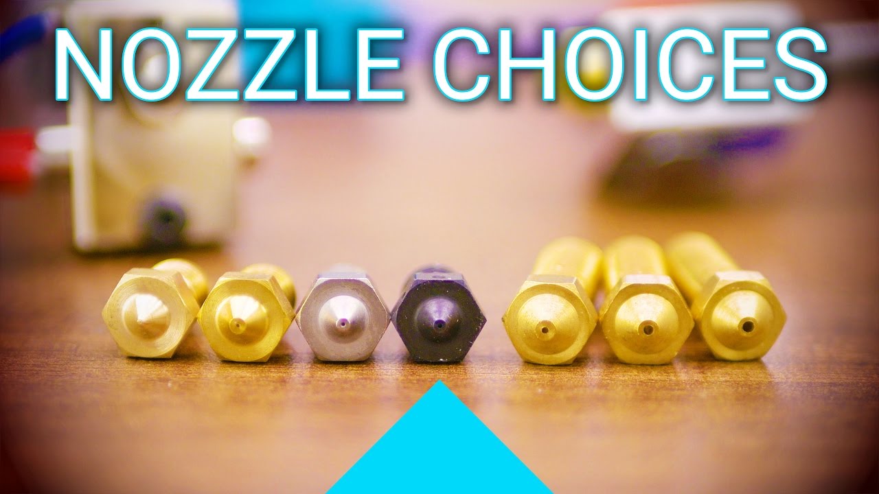

An x nozzle is a hardened steel nozzle made from vanadium carbides. It is very hard and resists wear. With brass nozzles and my typical printing amount (800gm a week +) I was replacing nozzles almost every week. More abrasive (filled materials, carbon, and glow) more often. When a material would string with settings that normally work well, or you get blobs and such, I pulled the nozzle. The X nozzle has run 6 KG and is still perfect as near as I can tell. It needs to out last at least 10 brand name nozzles to be worth it. So far so good.

Do the x nozzles have different bore sizes? Might be worth getting a couple of different size if they’re really that good.

I am very fast to replace nozzles it seems to me if you have a really high end car lets say an F1 race car, and then you put the cheapest tires you can on it. it will hurt performance. I always buy name brand nozzles they are better in my experience than cheap copies. People whom have machined them in half have demonstrated this to be true as well. I find they print better. Nozzles seem to be the last place to save a few $$.
I would suggest use a few brass ones for the moment, get used to the machine, the farther from stock you go the harder it is to get help. Hardened steel nozzles are well different. Hard to put a finger on it but in that odd voodoo gut thing. I think they takes longer to heat up so if the printer is fast out of the gate it might be cool for the first layers. This is the kind of weird crap that will makes you crazy. Stick to the standard one so when you do switch you are really familiar to ‘normal’ and it will be easier to tune abnormal in.
