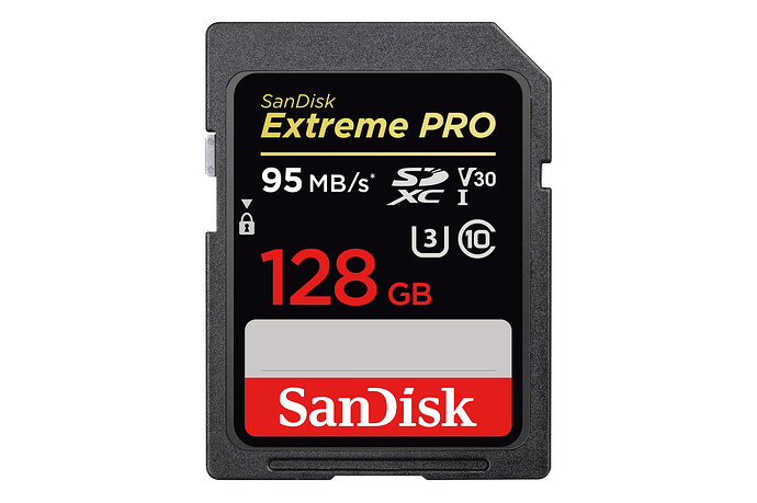

There are a lot of cards listed as Sandisk extreme or similar which are not the speed claimed or not even the amount stated on the sticker. these are counterfeit are are old or inferior cards that will not behave as expected. If it looks like a screaming deal it isn’t. It is very common.
