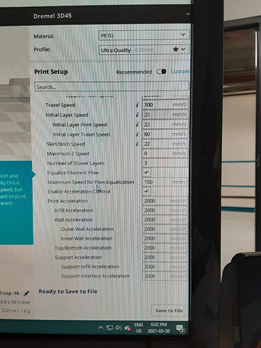

I took photos of the Dremel 3d45 Cura based Slicer settings.
Came out:
Expecting:
Just barely useable.
First menu of slicer setting, Quality:
Shell:
Infill:
Material: MG Chemicals PETG 1.75mm black.
Speed:
Travel:
Cooling:
Support:
Mesh Fixes, Special modes, Experimental:
I can post any other specific slicer setting upon request.
What size nozzle are you using? Can we assume 0.4mm?
Yes. OEM whatever that is from Dremel.
Logan5
4
Cooling fan speed is a little high. I only use 30% after layer 3.
Did you disable the printers auto settings and tell is to use only your G code file?
No. Itβs at work and they are a bit leery of doing that. Are you using a Dremel 3D45 at that fan speed?
Logan5
6
Any time I print PETG on any machine. 230 nozzle 70 bed.
