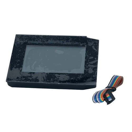

Can I assume that this is the screen you used?
Official Creality Ender 3 Series Touch Screen
As I mentioned earlier, I have found a few models available. some are no longer available. You pictures don’t seem to match the pictures on the 3Dcanada web site from the link… physical shape is same but screens don’t match.
after doing the install and digging around there are about 4 different versions of this screen. One is called a “pad” the pad is a little different it does attach and become a touch screen but it adds wireless functionality to your printer. From what I can find out it’s kind of like a octoprint replacement with a screen built-in. Not really what I was looking for. Apparently, there is a lot more configuration
What I was looking for was simply a touch screen so my younger children have the ability to use a couple of the printers without the complication of using the reprap style knob screen.
to answer your question yes that is the screen I chose. There are other sizes of them but I wanted something a little smaller. ( as it’s for the kid’s printer and not mine.) the larger ones were a bit of overkill for what I was looking for.
