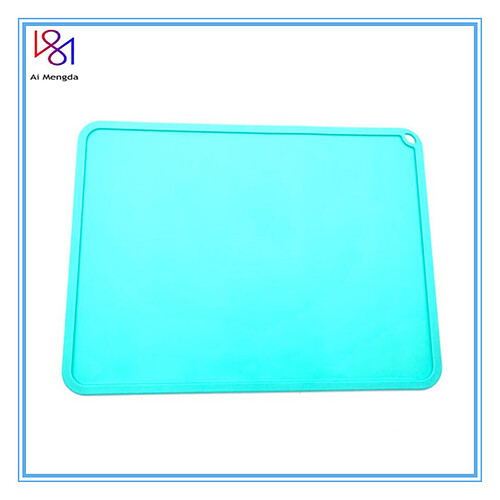

Sorry, I should have noted that I put my printers on silicone pads - that does seem to dampen out motions a bit, prevents rocking (which you shouldn’t have because everything is square, but, you know) and protects the surface the printer is sitting on.

What kind of pads (specs.) and are they available commercially.
I got mine from AliExpress:
I was suggested to use these for FDM printers years ago - I know they’re for resin printers but they last forever, even out the vibrations and anything that drops on them doesn’t bounce away.
OK Thanks.
I use these ones under my printers:
