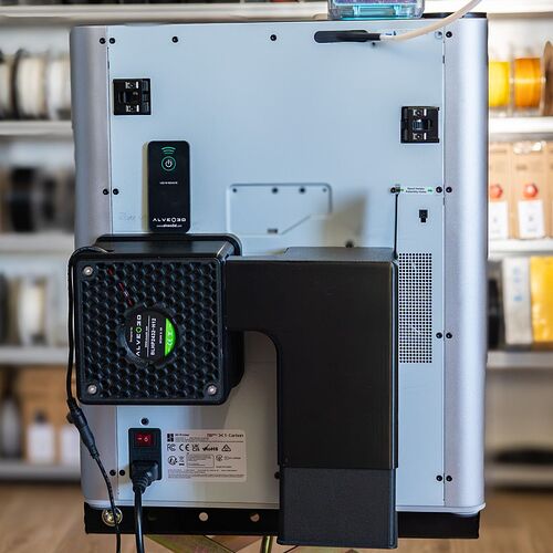

I have 2 P1S printers. I have been trying different things with each. One I have a Bento box inside. The other I bought the AlVEO3D kit.
The AlVEO3D is way better. It is fairly expensive. The bento box is better than nothing I was going to figure aunt triggering but never got around to it. I have a top lip thing that guides the wires out. I have never needed to open the top of vent anything (pla)
I have AlVEO3D on my Prusa (s) They work super well. Sadly the P2S is the worst stock and the U1 is ok stock. I need to address both at something. The Prusa with the AlVEO3D is remarkable. I can sit 4 feet from the enclosure printing ABS with zero issues and the air quality meters don’t move.
Air quality monitors is a bit sketchy, the cheap (affordable) ones don’t test micro particles and VOC it does but it is crude. The good ones are prohibitively expensive.

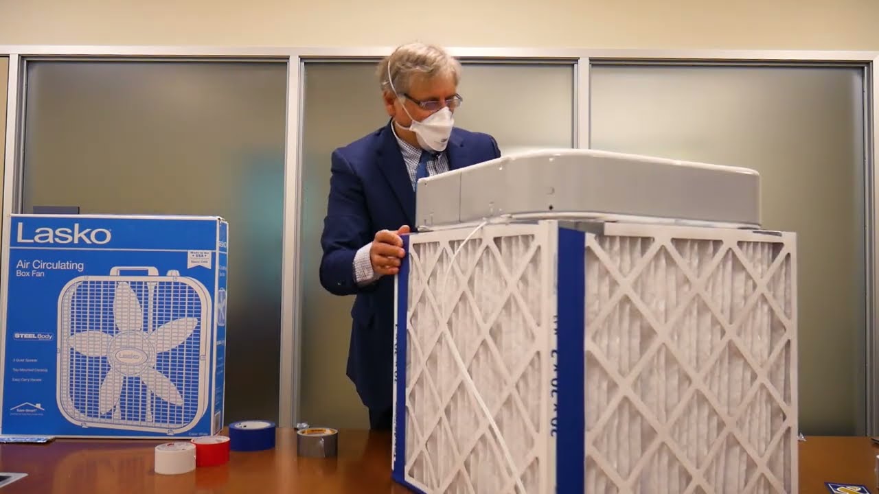

This type of homemade room filter is very popular and relatively cheap. With the right filters it will even clean virus’s (Mirv 13). It should make a big dent in the air quality problem in your basement.
Thanks, I just looked up the Alveo3D FE150, yeah it looks seriously powerful, but damn… €720 is kinda crazy :sweat_smile:

Looks pretty solid tbh, simple but effective.
I might give it a try when I get the chance :+1:
Mirv13 is not very effective with micro particles or voc. You might just end up moving it around more. You need true hepa13. 99.95% of 0.1-0.3 nanometers the merv13 is 50% and not always tested below 1.

I put a hepa filter on the back of my printer with the existing charcoal filter and the fan couldn’t blow air through it. I would have though Mirv 13 would be good because it will catch viruses which are very small, maybe not. What about a table small top hepa filter sat beside the printer?.
