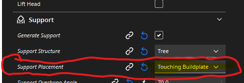

Maybe try this?
Thanks for the reply. I have that selected. I’m going to try Cura again. And adjust the diameter
