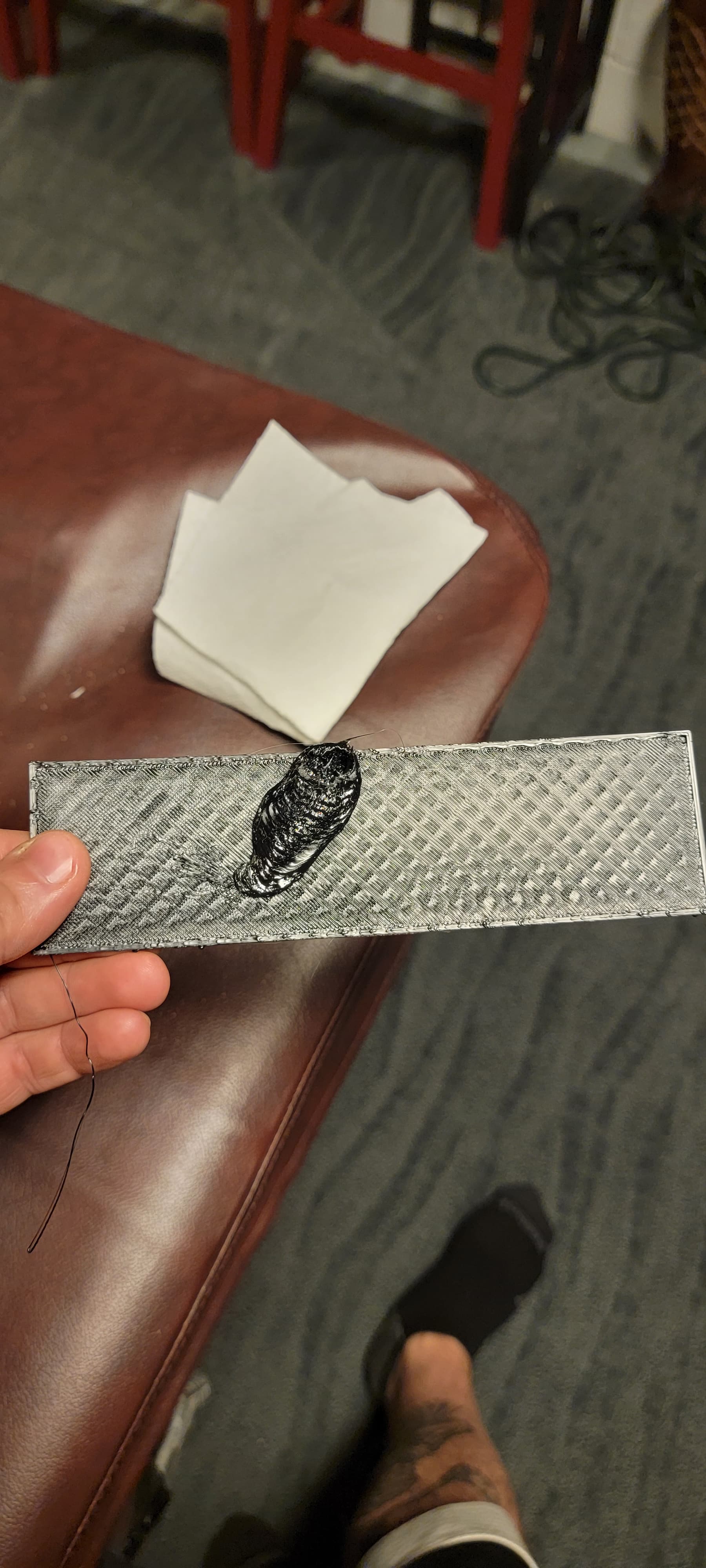

No matter wat setting i use. I can not get abs plastic to stick to my bed past the first couple layers. It does good then this happens.Processing: 1000005817.jpg…

Seems like the first layers only hold for a certaim amount of time and then the edges curl up and it lwts go of the bed

The reason that your print is warping is that as ABS cools it polymer will contract which causes the print to start to warp. This is why enclosures are used, if you can heat up the air around the part it will cool down very slow and will not warp. The enclosure also helps to keep you safe while you print the material.
I would highly recommend not re-printing using this material until you get a proper enclosure for the machine!
