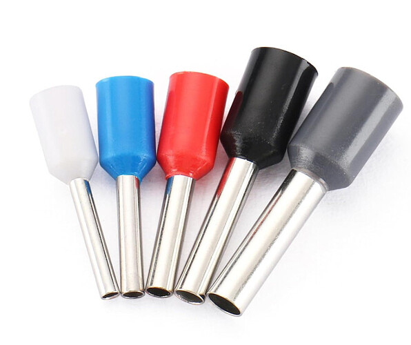

The Power connectors input and Heater connectors (E0 and E1) output require Ferrule connectors, Please do not “Tin” the end of these connectors with solder and use this way. These connectors are designed to be used with Ferrule connectors that will allow proper connections. Amazon

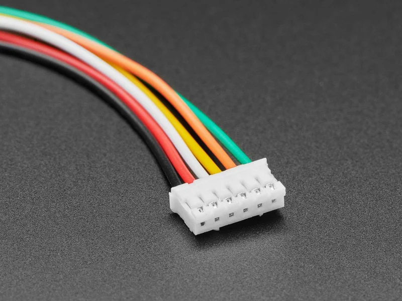

On a typical 3D printer the Connectors on the stepper motors are called a JST-PH 2mm pitch.
DigiKey also has a kit for these as well located here.

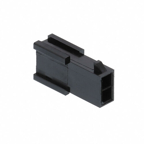

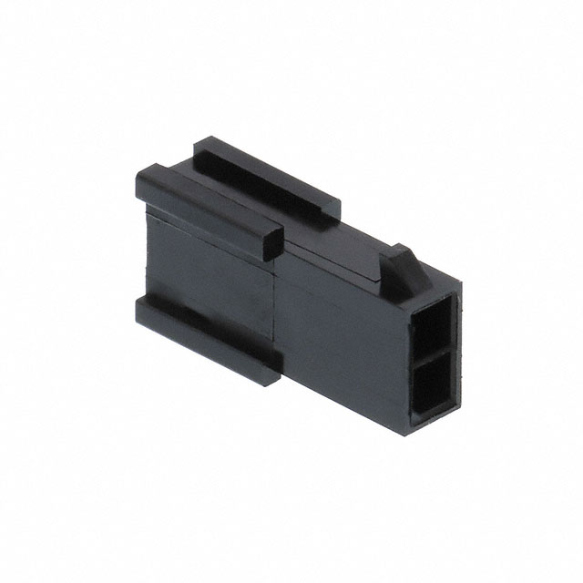

Some new style connectors in use on some newer printers are called a Molex Micro-Fit 3.0 Vertical, The connectors are as follows
Tin inserts are located here
On the mainboard opposite side you need these
Tin Inserts are located here

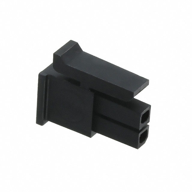

a similar also have a different connector. They are called a Molex Microfit 3.0
Male side here. Don’t forget to order the female pins.female side is here. You need the male type metal pins for this one.
