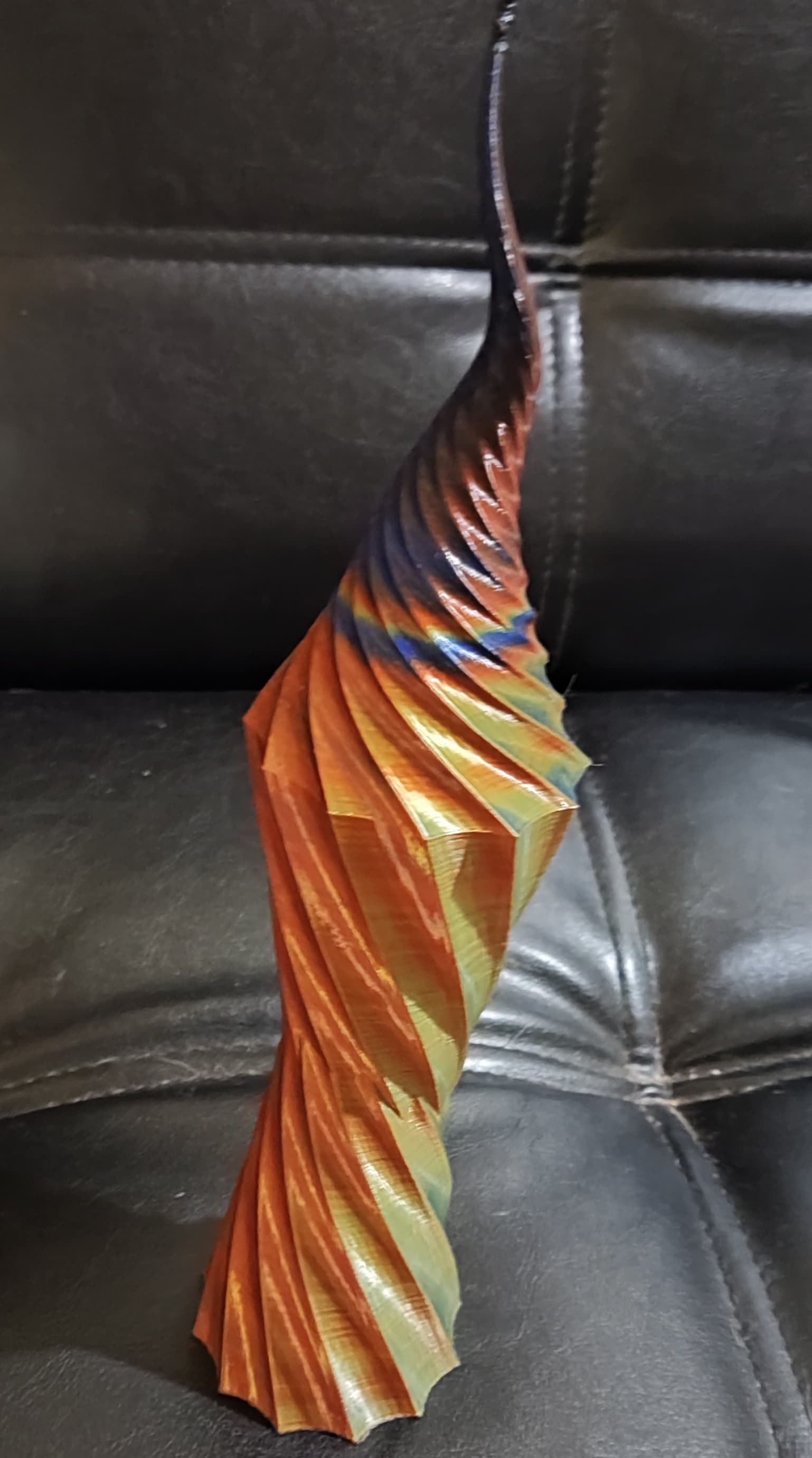

so what i detected was different artifacting depending on the color used;
same g-code,same-printer,same filament dryness…
the first 2 photos are the overall models ( just to provide some context);
the 2nd 2 focus on the artifacting; the silver artifacted quite a bit less than the gold;
so in going from silver to gold, the artifacting in the 2 faces shown went from 2 to 6 (interestingly in different positions…);
thoughts ?

yikes, that is exactly what i feared and didnt want to hear;
tests on each spool;
and then there is also inconsistency within a spool, correct ?
note the following:
while some might consider them ‘pretty’ and surely ‘unique’, they are anomalies which i doubt i could reproduce;
can anything Other than intra-spool inconsistency explain this ?
