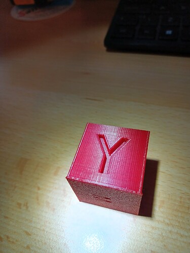

I got my new bed installed with the flexi magnetic bed and made this XYZ cube came out perfect and it lifted straight off the bed. Even the bottom and top look good. (The letter M was on the bottom). Al looking good now.
