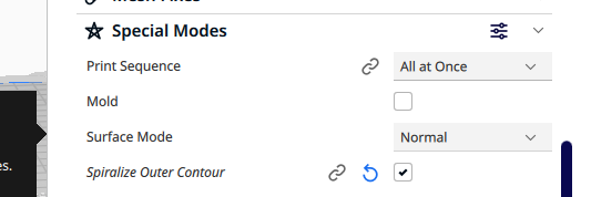

I think the file needs to be run in ‘‘Vase’’ mode or spiralize to get the vase shape.
I tried to find vase mode with no luck?

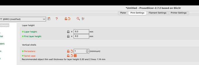

Different names in various slicers Prusa slicer (orca and Bambu) it is spiral vase Cura says Spiralize outer contour
Thanks i found it trying to print now.

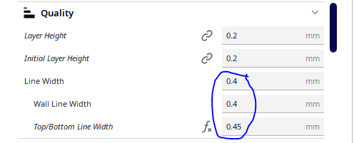

Ok its printing but the wall looks very thin how do i thicken it?
Make your wall thickness bigger, I have done vase mode, with a 0.4 nozzle at
0.8 thick.
Thanks i am still learning settings. The vase is printing as it should now but the wall is a bit thin. Where are the settings for the wall please?
Using ender 3
Change the noted wall thickness.
