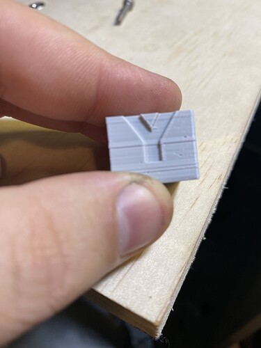

Hi everyone I’ve been having trouble with my printer lately and I don’t know what to do about it. I’ve had the printer since they first came out I bought it from 3D printing Canada and it was doing great for years until now compared to my father’s Ender 3v2 my z motors and x motor are louder. I did upgrade my printer with dual z from Amazon as well cr touch and recently bought a creality direct drive. These upgrades were okay but the direct drive seems to be a pain as well my dual z. I apologize if none of this makes sense.
