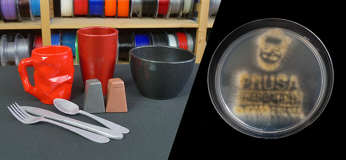

Food-Safe 3D Printing: Design Tips, Materials & Finishes | Xometry Europe.
