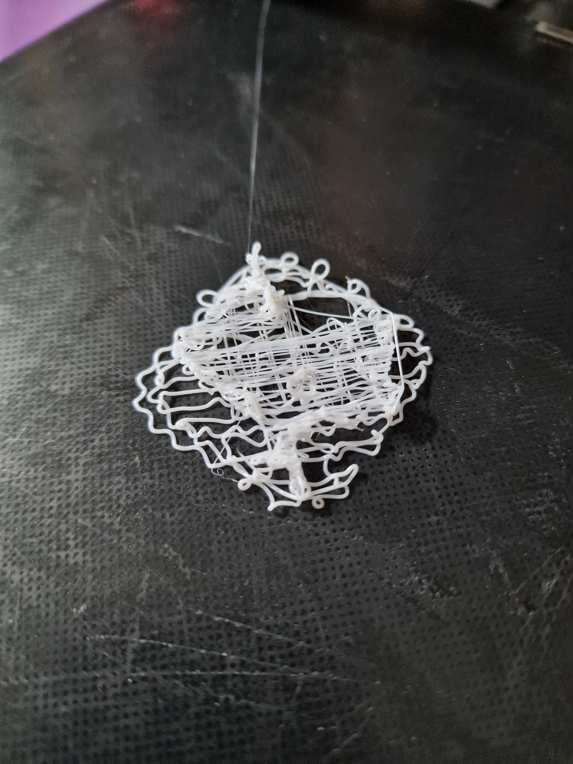

@Fubz do you by any chance have a pic of what the first layer looks like?
It would confirm and tell us if its a z-offset issue.

20230328_145723
all this is just printing the xyz cube, i have printed things off before in the past but i have done something in the settings and i don’t know what it is
i use the stock bed, yeah glass and if you look on the reply i have sent to Jason, that was prinited on a clean slete and then on printer glue stick
Hi there,
This is definitely a z-offset issue, the bed is currently below where the printer thinks that it is. You will have to adjust the z-offset to lower the print head down onto the build plate. I have included a link to how to do this below.
