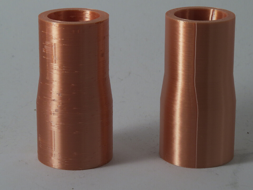

I found a very good Prusa slicer profile for Flsun v400 by Rey Alicea:
You can see, same model sliced with Cura 5.3.1 left side (seam random) and sliced with Prusa profile (seam aligned). Prusa slicer have better result with seam aligned. Cura leave small bumps all over even with seam aligned.
thanks , i might try using prusa slicer on some prints that slicing with cura failed at print-time for anomolous reasons

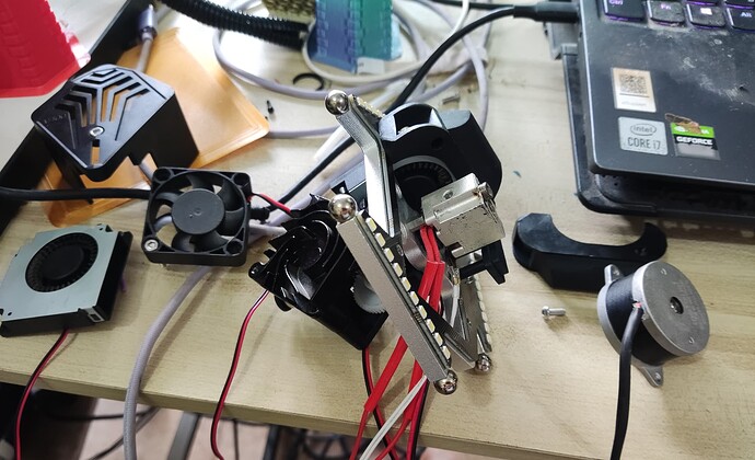

well i think my flsun v400 days are done, the latest big clog required me taking the effector head completely apart, it looks like somehow the gear axis had gotten off and the interior gears werent turning well (manually) i reset that but it highlights a serious flaw in this printer;
overall it has become too much trouble for me;
i will move on; recent searches have shown there isnt another printer at this feature and price point if you absoltuely require tall z, fast speed, wifi, (quoted) printer accuracy, etc;
so i might put this back together and print until next-big-problem but that will be it for me with this brand;
then i will wait, maybe revisit the market in 6 months, and hope another manufacturer ( i hope prusa) will offer something decent
** the initial issue here was a clog, i replaced the nozzle, nothing, then i took the nozzle off, no filament could be loaded, with or without the unload lever engaged and doing the feed manually
i will provide photos of what i am about to try to describe narrationally;
the “clog” i ran into isnt really a clog so much as it as a ‘jam’;
i took the effector head completely apart, not fun considering you might have to reassemble it;
i wont have to do that;
fatal end;
there is an area in the overall flow just above the top of the heater block , in a metal sleeve area that , IF, the solid filament breaks there, or a broken fragment is forced there, will block all fixes from above and below;
that area is above the heat so heat wont help;
that area , when blocked with hard filament will require a new effector head as the only remedy as there is no way to get that hard filament out of that area;
i have contacted flsun about this and they offerred me a new effector assembly;
that doesnt fix the design flaw and in theory you could be replacing effector assemblies every day;

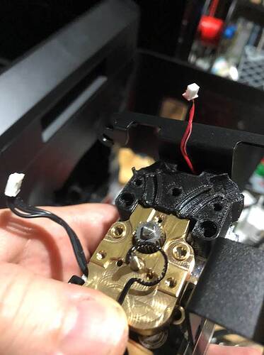

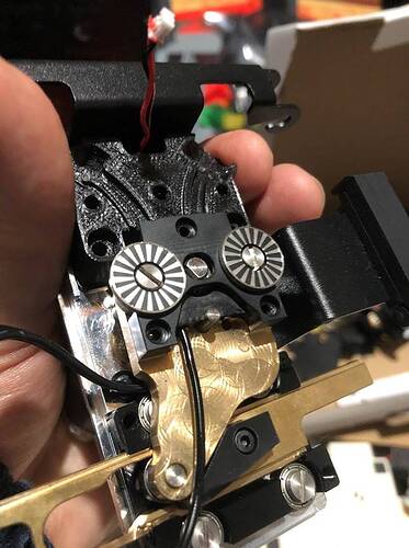

I just dug out some of my pictures of the problem.
The first one is the partially disassembled toolhead - the two striped wheels are the filament movement sensors I mentioned:
And here’s the cover removed with the filament wrapped around a drive wheel because the PTFE tube got worn out:
