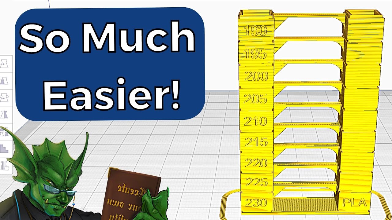

You probably have a temperature change set in Cura’s “Post Processing” using the “ChangeAtZ” (IIRC) macro.
It’s explained here:
Thanks- I had checked that script a while ago when trying to create a temp tower. I didn’t realize you had to shut it off again. That was very helpful!
