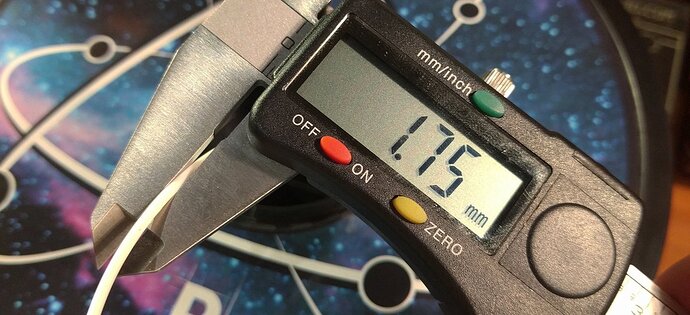

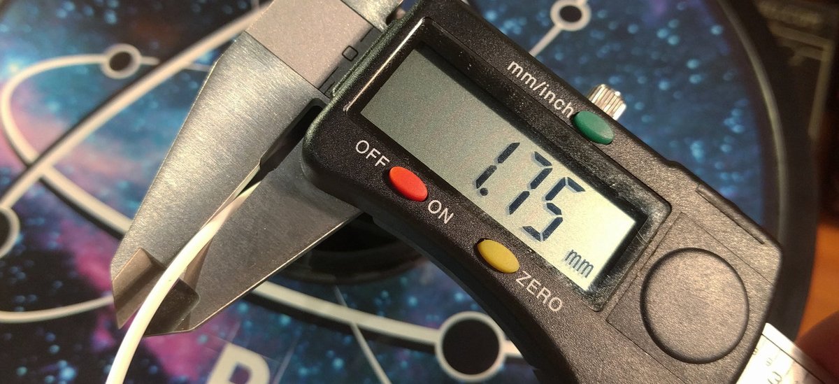

You’d be best to do one thing at a time. If the printer isn’t working with the new firmware go find the original on creality’s site and flash that back on the board.
Once you’re back to that point then focus on the extruder. If you call for 100mm but only get 50 then that’s your problem right there.
I’ve followed similar guides to this before. I find it easier to follow a list than a video.
