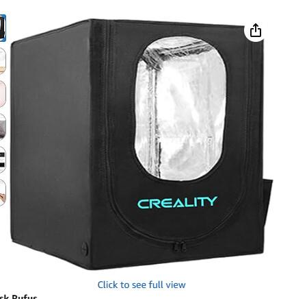

I have a commercially available soft sided enclosure for my Creality CR10S Pro.
It is excellent in keeping out drafts and the inside temps are more stable but not really controlled.
I got it mainly for printing PC and PETG.
Well worth the money. similar to show

Concur with Loosenut - do not print with enclosure sealed - I’ve got generic large format printer softsided enclosure like the one Hobbymaker pictured. I find it’s great at keeping the printer from becoming another horizontal surface, keeps the amount of dust down, but sealed, your PLA will just become a big ol ball of goo and spaghetti of differing proportions, ask me how I know. In theory, the chamber offers some fire retardant protection, but I’m not willingly going to test that, and I don’t know who’s standards mine were really tested against, and if the certifying lab was really accredited - It was a gift from she who must be obeyed, and you only ask so many questions right?
Even with the door open, the enclosure does cut the noise down, not that the CR10 Smart Pro’s the loudest thing on the planet to begin with. You may still need to regulate the ambient air temp of any enclosure, so thermostatically controlled air venting, with good hepa and carbon filtering would be ideal for ABS, ASA, Nylon etc. Though, as Kitedemon points out elsewhere on this forum, air quality is a concern period, so technically air filtering would be good for PLA and PETG as well but you’ll have a much more active fan running to keep the ambient temp within what PLA tolerates.
