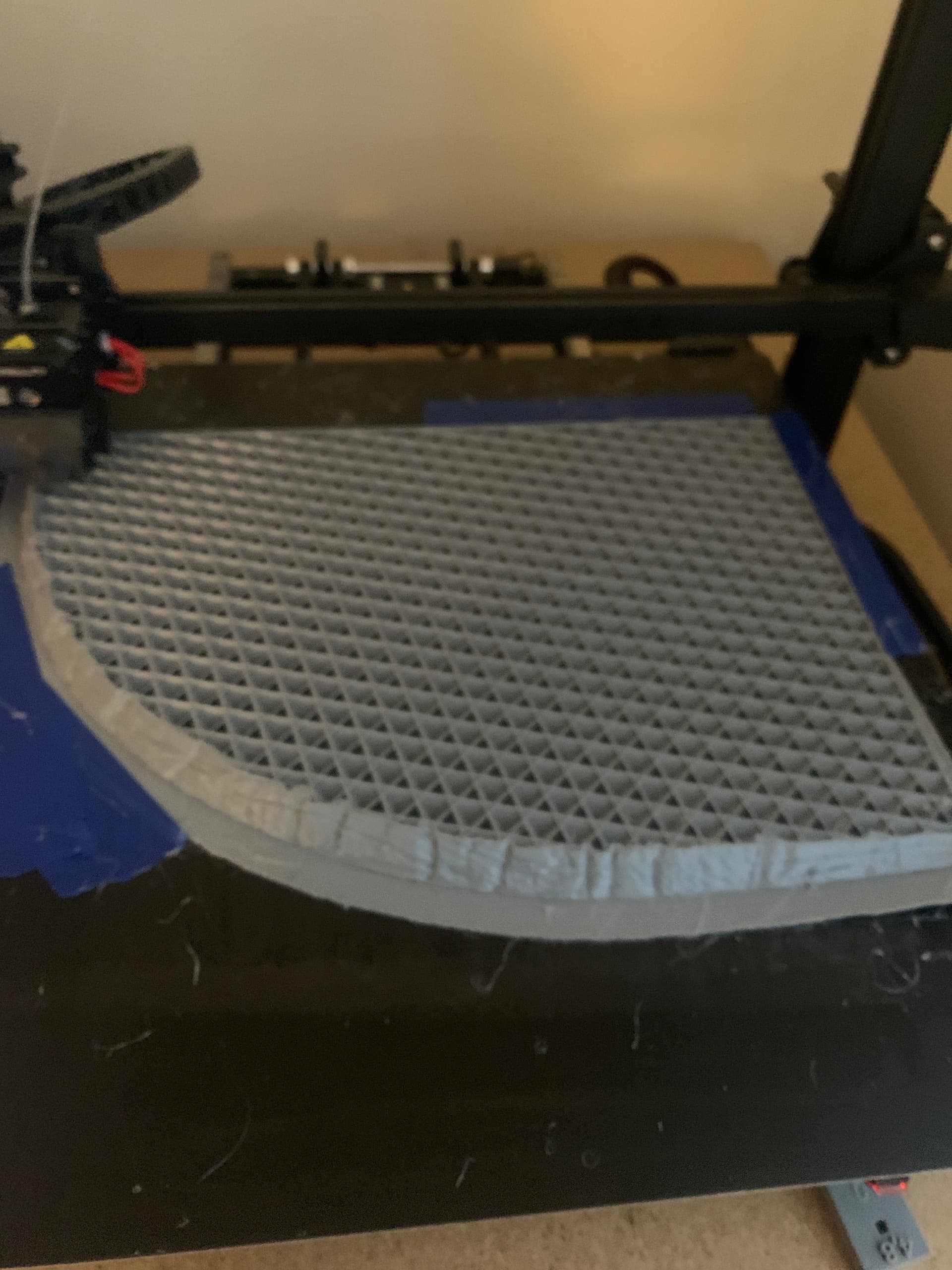

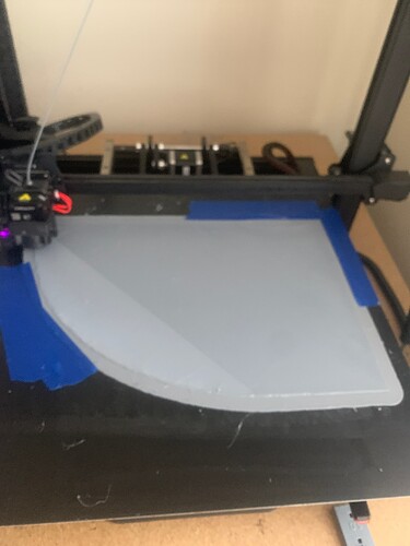

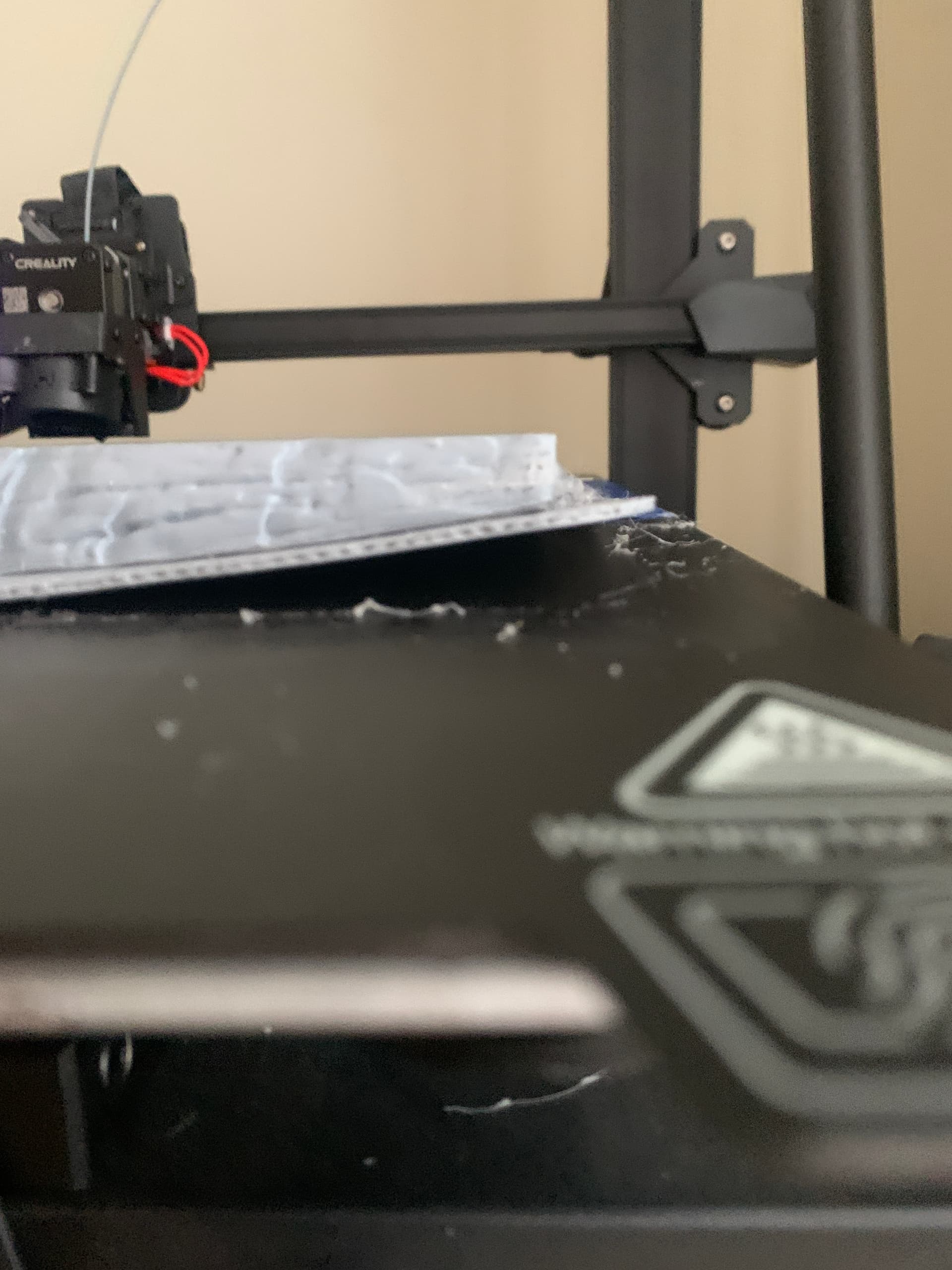

My model was lifting on my CRM4. I taped down the parts that were lifting however and it seemed to help. What can I do to prevent lifting on my prints using the CRM4?
that looks like warping.
A different design, an enclosure, a draft shield.
It looks like you are using a brim so that is good, making it bigger is one option. Large area prints are always a potential problem in this regard. Adding mouse ears to the corners might help since the lifting starts at the corners and the extra adhesion will help. As Kitedemon says a draft shield could do it since it stops drafts and holds heat in the model so you don’t get the cooling that causes warping. In Creality Pint, Orca, Bamboo Studio it is under the skirt settings. Basically it is just a skirt that keeps growing up with the rest of the print and holds the heat in. Worth a try. I’m not sure where to find it in Cura but it is there someplace.
I am using a raft. Creality Print is not compatible with CRM4 printer. I use Creality Slicer but the brim feature creates a skirt around the model instead of a brim
Have you tried Orca or Prusa slicer? Their profiles may be different and work, then Creality Print.
Is the model one you created or a download?
Can you import it into a cad program?
There is a mod where you actually create a brim right in the model, as part of the model (down side is you have to cut it off after the print) instead of the slicer. It is a Hail Marry for difficult prints with trouble like you are having. If you can’t do it then you can email me the file and I will try and do it for you. Let me know.
I downloaded Cura to have a look at it. Maybe you knew this maybe not but you have to turn Brims on. Go to BUILD PLATE ADHESION/BUILD PLATE ADHESION TYPE click on the box, it might say raft or skirt or none if it doesn’t say brim. Click on brim and set the variables. This will give you brims, Since you are having so much trouble maybe you should try setting the brim to 15mm wide.
P.S. if these settings are not visible then go into the preferences settings to turn them on.
