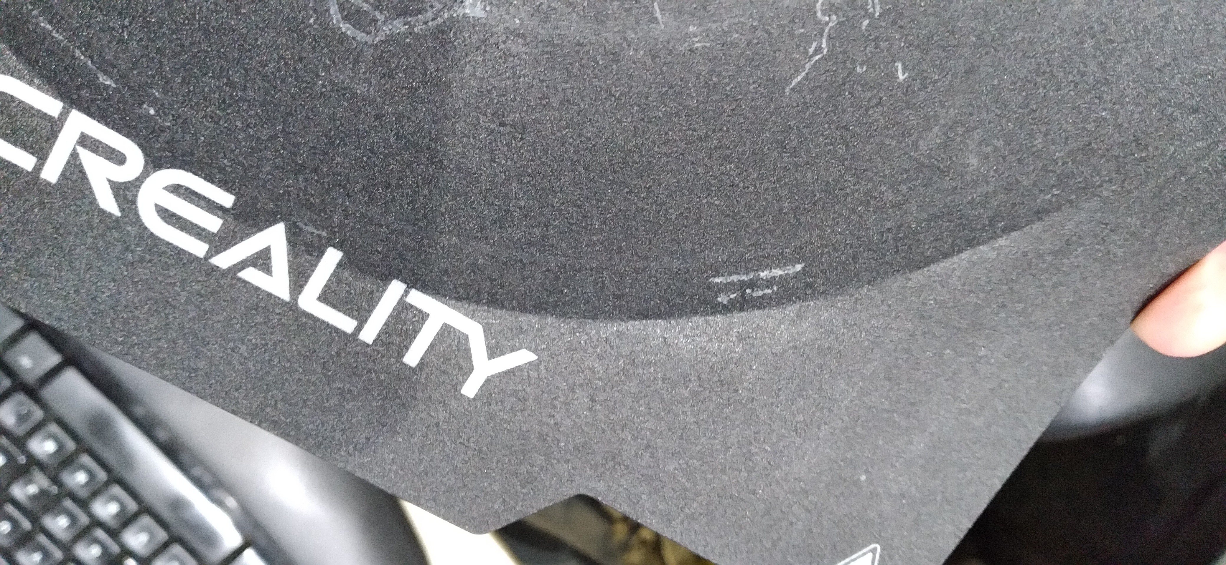

I bought one of the flexable fridge magnet type build plates from creality and comparing it to a spring steel sheet… Id pick a spring steel sheet. The ridgity of the spring steel feels better to me, though its still attached to the build plate with a fridge magnet style sticker, i feel it has enough “stick” to feel comfortable.
Mind you i was introduced to the steel sheets from my prusa mini where the magnets in the buildplate are strong enough to almost lift the printer by the removable steel sheet alone.
