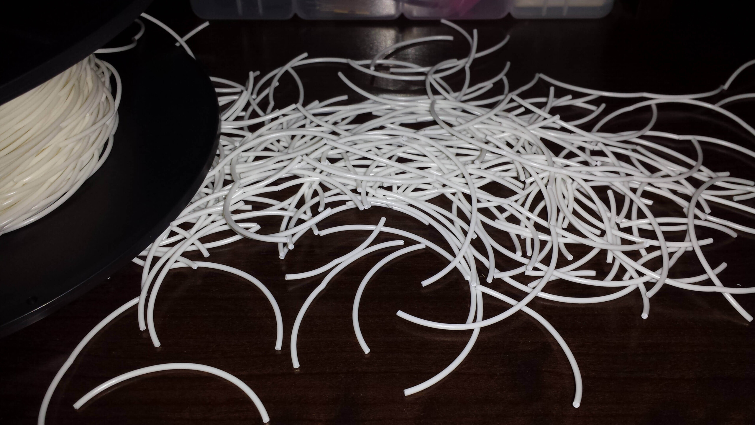

My filament is brittle, what do I do?
There are 4 possible reasons as to why your filament is brittle. Moisture, temperature, sunlight, and/or oxygen.
Place your filament in a PrintDry machine or food dehydrator 60 degrees Celsius (judging by the severity, drying time can range from 2 hours to overnight). Once the filament is dry enough for printability, store unused filament in a cool dry place. (silica gel does not draw out moisture, it simply maintains the current moisture level).
Agree - dry it out. I was having issues with some older PLA that got real brittle. Purchased a food dehydrator on Amazon and printed the adapter shell I found on Thingiverse so that I didn’t have to destroy the original, in case we ever want to use it for the intended purpose. Worked great - now able to use a role right down to the last dregs without any issues. Much better than throwing away unusable filament.
Found that 4-5 hours at the 60C setting did the job. Checked with digital thermometer just to verify temp.
