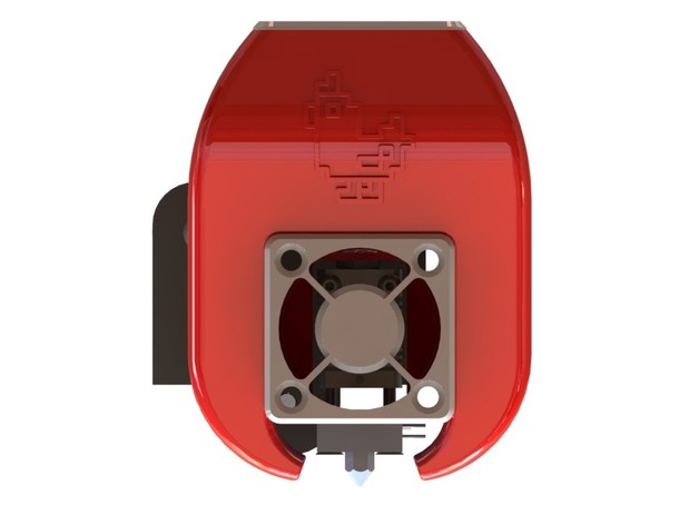

This should be a good one. I use their other one with the 5051 blower fan for cooling.
I remixed the top mounting hole to align with the hole in the Ender V2 X gantry plate. Use the shorter, silver M3 screws found when you take apart the stock fan shroud, not the one that is normally used to hold the stock fan shroud.
