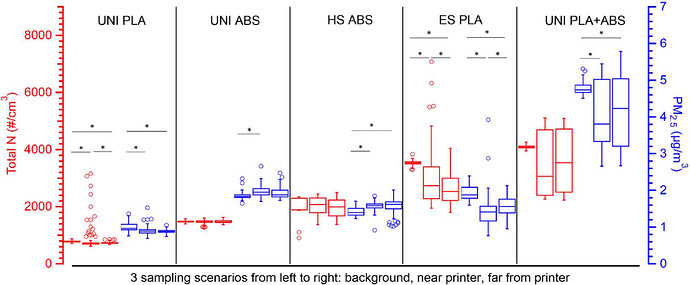

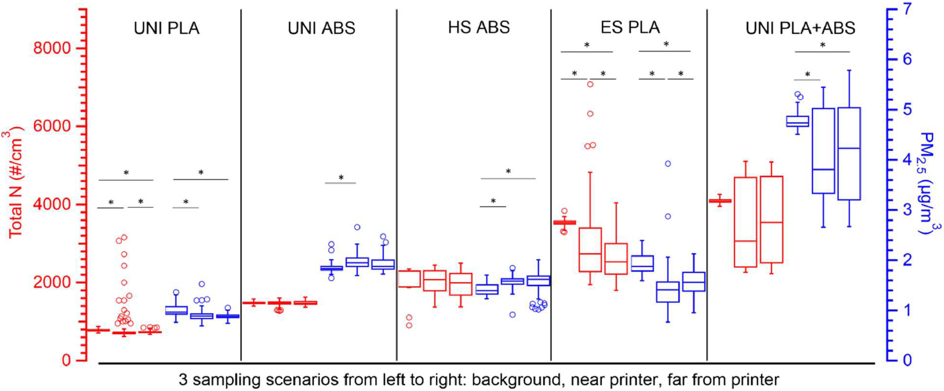

That is actually not correct. PLA produces more Ultra Fine Particles (UFP) than other filaments. Volatile Organic Compounds (VOC) is what you are thinking of.
VOC is often associated with smells, reproductive issues, and cancer.
UFP is associated with allergic reactions, breathing issues (bronchitis and asthma) central nervous system problems (Parkinson’s, cognitive decline) and cardio vascular issues.
PLA VS ABS abs more VOC less UFP PlA less VOC more UFP. the next result they are about the same health wise.
I have enclosed all my printers (11) and I have filtration in all of them. I know there is a lot of white dust on the inner surfaces and I clean it away every 2-3 months.
https://www.sciencedirect.com/science/article/pii/S0360132325008030
