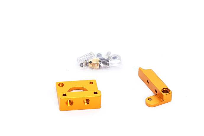

Ok new info on this dilemma. Looking that the extruder Found a large crack down the top from the bolt connecting it to the plate to over the bearing
Ah, the curse of the plastic extruders. For the life of me, I don’t know why Creality even tried to get away with using a plastic extruder. They all crack, and when they do they don’t grip the filament properly. The only (sane) solution is to replace the extruder with an all-metal one.
https://3dprintingcanada.com/products/mk8-aluminum-extruder-parts-left-hand?_pos=19&_sid=945945a76&_ss=r
I’m just never sure how to tell the left-hand from the right-hand type. It really only matters (as far as I know) with a dual-extruder sytem where having two of the same type would leave one of them with an in-accessible lever.
While you’re there, load up on other common replacement parts and filament and remember to use the 3DPC10 coupon code.
the left hand or right hand I believe is the open side of the lever if you are looking at it from the front, with the infeed of the filament at the top.
Most creality machines are Left hand. with 2 exceptions that come to the top of my head, Ender 6 and anything with the duel bond tech style drive gears.
If that’s the case, then the Ender 5 Pro has a right-hand extruder.
