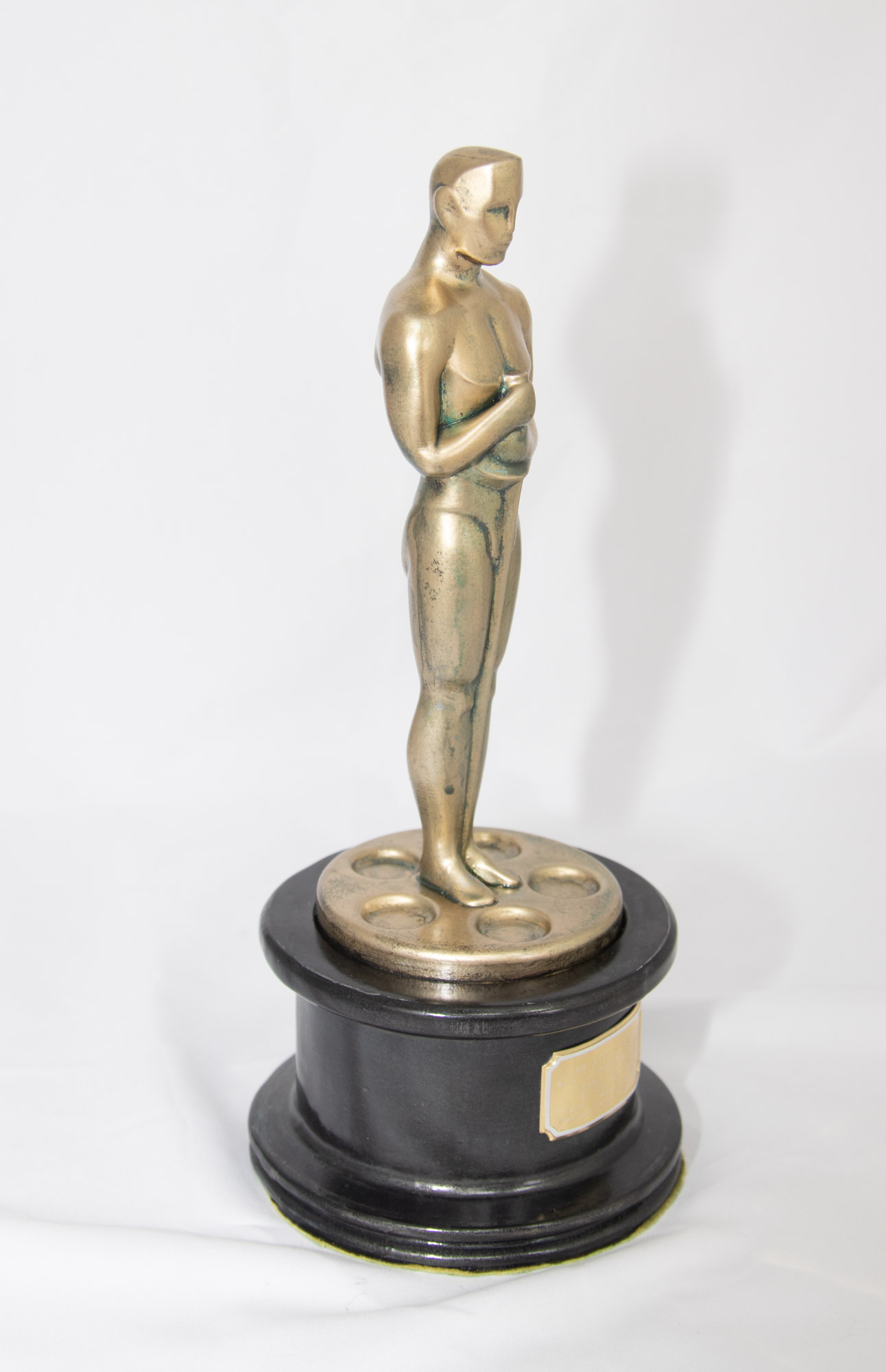

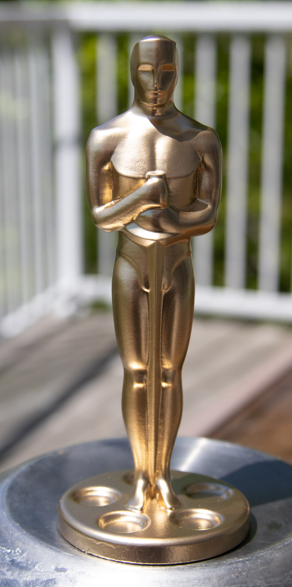

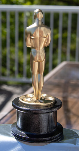

I have resin printed an Oscar for a friend who has being teaching in an Art & Design College for 37 years. He was one of the lectures who taught me 3D design, many, many years ago.
Now working on the base and plaque.

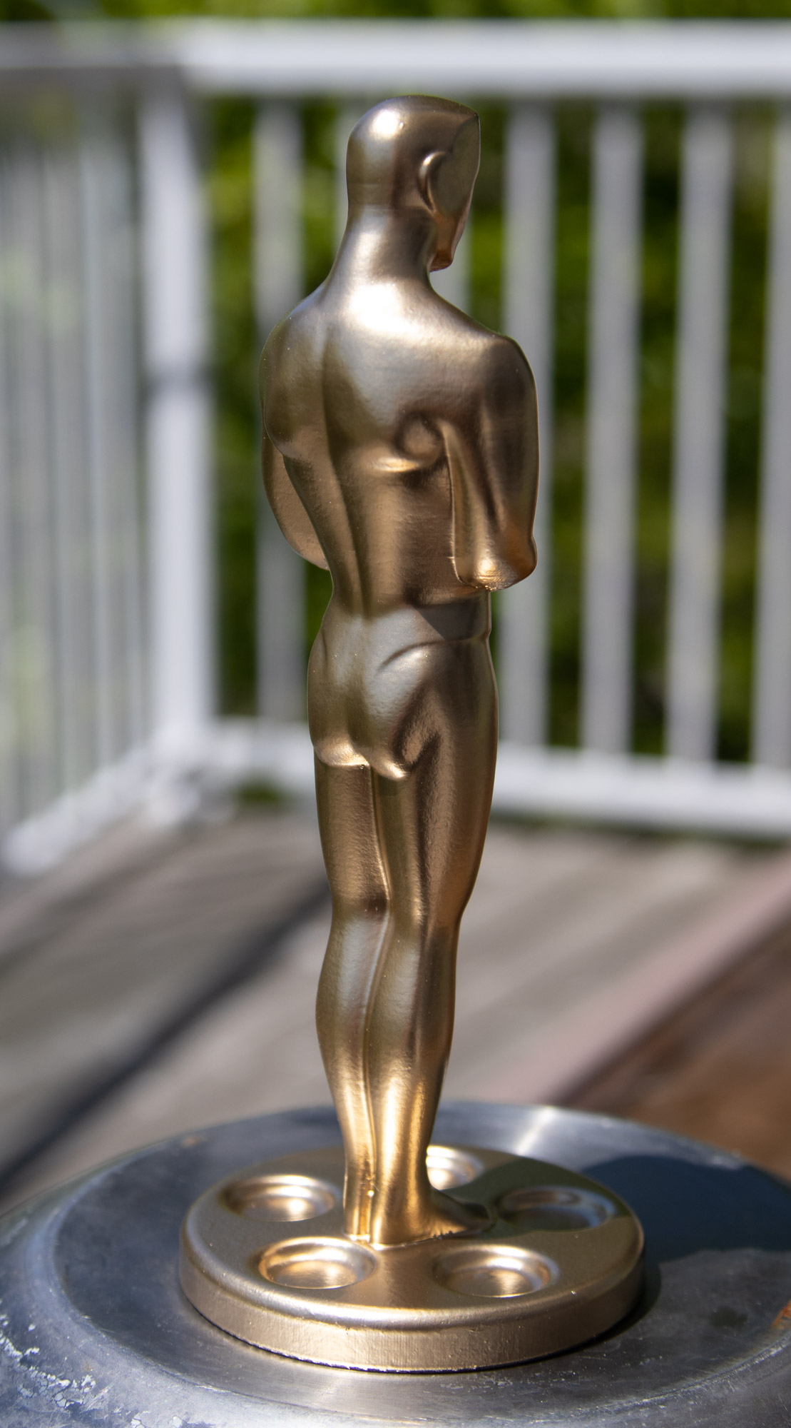

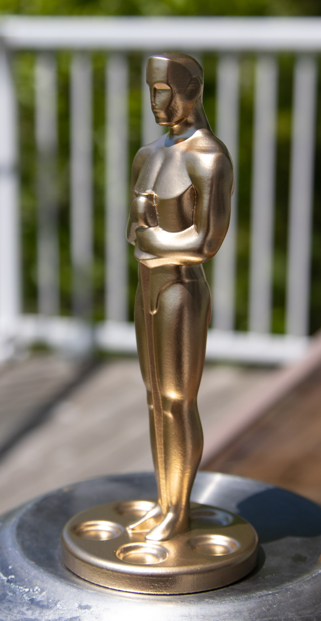

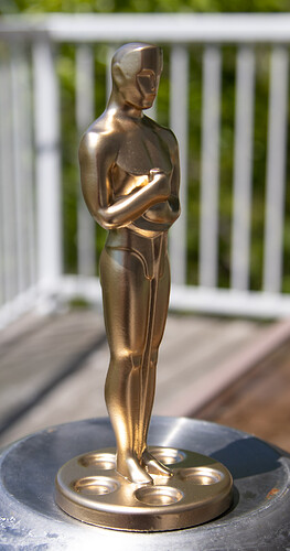

LEGOManiac, black water washable resin for this version. Model was printed in two halves, then glued together due to size, primed and carefully sanded, then painted silver with arcylic, then mixed gold & clear coat together for the paint gold coat. Followed by a few coats of “pledge” clear coat. Then left a few days to harden off. Then a very, very light coat of rustolium gold mirror effect.
I did produce an FDM version prototype, worked fine, but requires a lot more sanding & painting to get a smooth surface finish.

My painting steps.
1/ A very light coat of rustolium primer designed for plastic…
2/ I use in-expensive water based acrylic hobby paints, mixed with windscreen washer fluid, consistency of milk.
Very lightly airbrush the first few coats. A very light misting for each coat, use a hair dryer to dry quickly or wait just a few minutes. The first few very light coats are critical, you will be able to see the original color of the resin/primer.
3/ A few more light coats of colour. You will notice the acrylic paint now sticks nicely…
IF you get paint runs, don’t worry… Wash the object under water and all the acrylic paint will be removed…
4/ You can hand brush the acrylic paint, it dries pretty flat. I tend to do fine colour detail by hand brushing.
5/ The overall finish will be flat colour at this point. Time to clear coat with “house hold pledge finish” available at most super markets in the cleaning area. apply first coat very lightly, wait or dry with hair dryer. Second coat also apply very lightly. 5 or 6 very light coats and you will have a nice glossy clear coat finish.

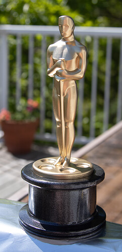

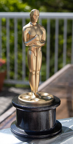

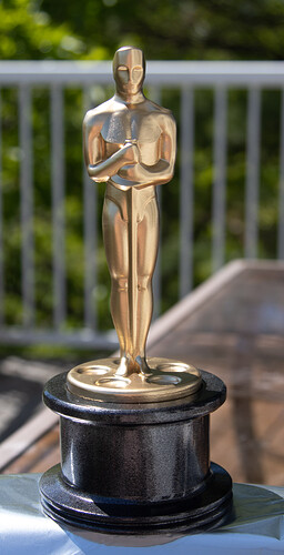

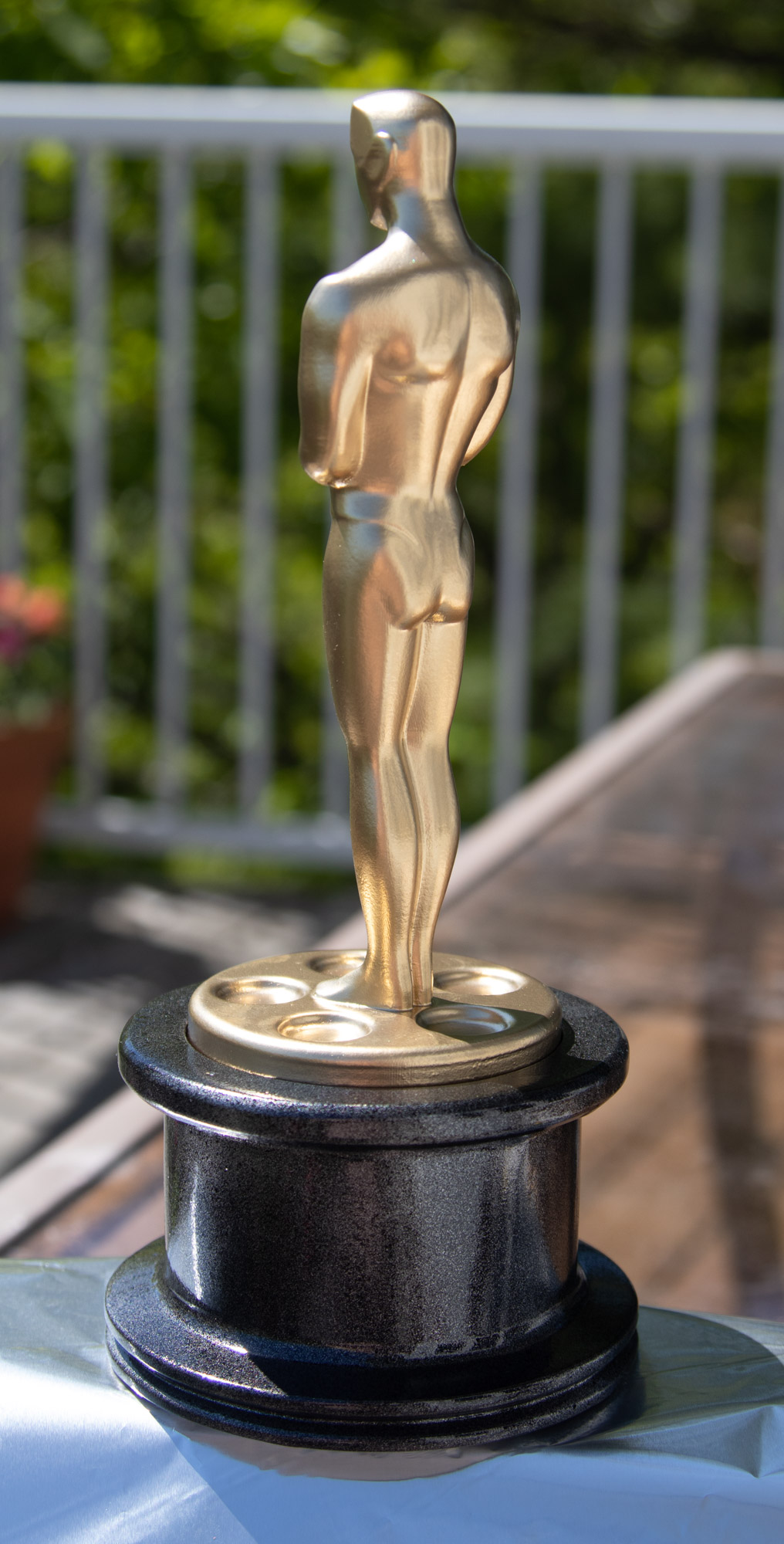

Resin printed the base stand last night and painted today, so now just waiting for plaque. Then it can ship to UK for the surprise event.
Finished piece is 14.5" high.

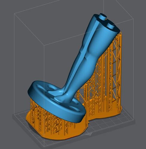

This model was created in 3 prints on Creality 002H, using almost the full volume of the printer.
Sliced using Lychee
The base has a secret compartment and plug. I will add some lead shot inside this version, so the overall piece has a little weight. The whole object is hollow, so pretty light…

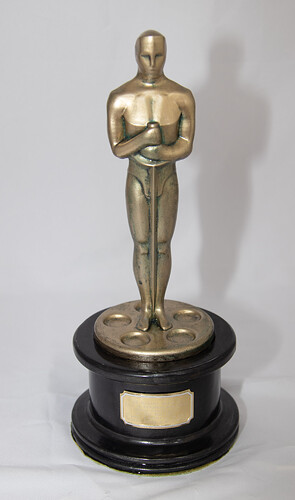

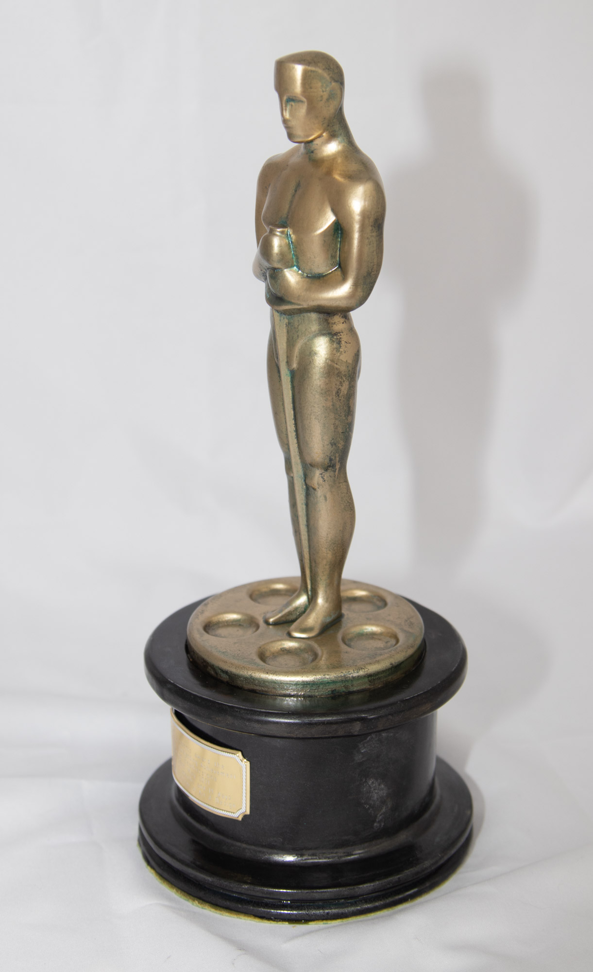

I decided to add a little “age” to the Oscar tribute gift. All finished and will be sent today. A fun project…
