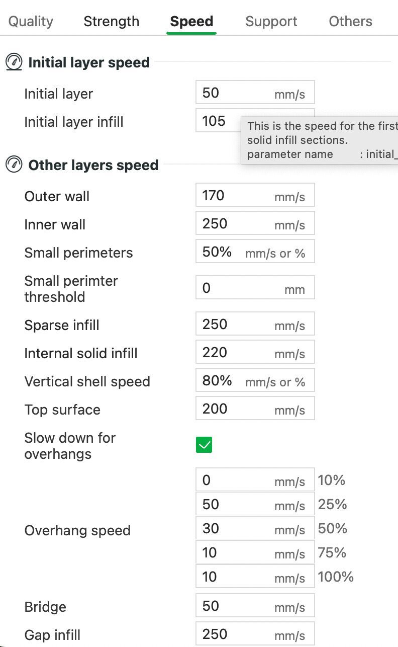

Hi all, looking for some advise. I just upgraded my hot end to a hardened hot end so I could experiment with Bambu lab’s PETG CF material. I’m using the bambu profile for the material. but this is my first print with the new hot end and material. You can see the underside of the bridging area is stringy and I’m getting the occasional blob.
Any suggestions on the next step to resolve this issue?

I have consistently found with my Bambu it prints faster than it should. Hardened steel magnifies that by being less thermally conductive. Try slower print speeds and or longer pre heating.
