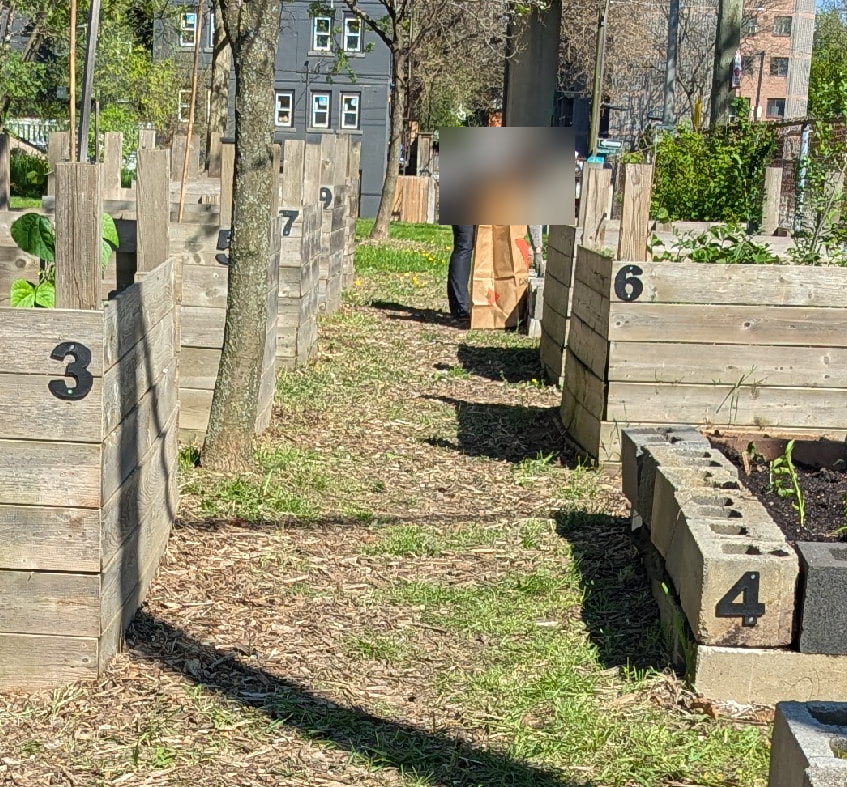

I printed out these PETG garden bed numbers a couple summers ago and they’re still holding up great!
