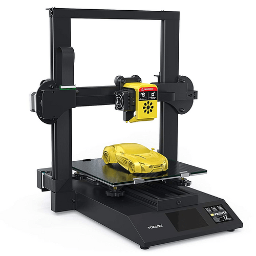

might be a good job for Goofoo heh.
Beat me to that one. Who knows how well it will work but…
