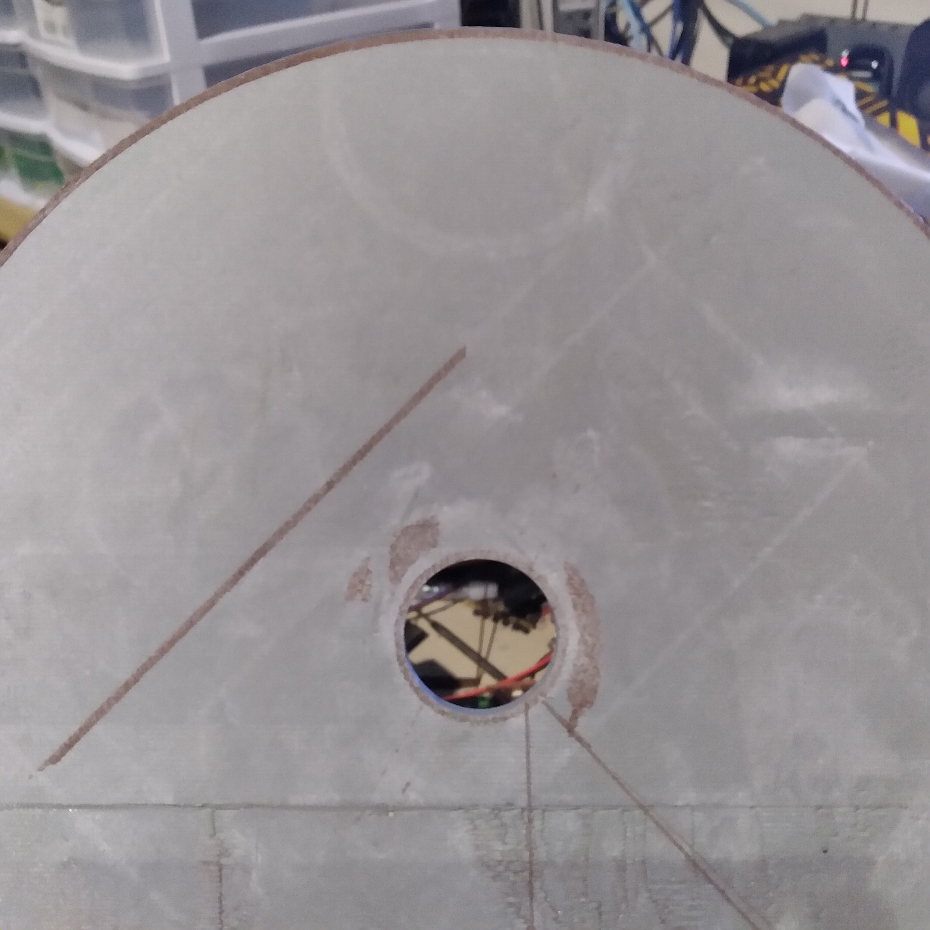

So I’ve been attempting to level the bed and get a good first layer for 2 days now. My latest failure was looking good until the far back corner turned out to be way to close to the nozzle so the 1 layer test print smooshed in there so hard that I feel like I’m going to destroy the bed trying to scrape the damn thing off.

Well I re-heated the bed and peeled it off so I guess we’re good there but there’s some residue I can’t seem to remove. I think that’s how it is now. Oh well… onto attempt #57 to get this thing properly leveled…

I’m using the Creality magnetic bed. It has similar problems, not because I didn’t level it, but because the underlying bed has a bulge in the middle. If you level the corners such that you get good layer adhesion, the middle will be squished.
As for the residue, don’t try to scrape it off too vigorously; that just wears down the surface and causes more adhesion issues. Instead, I made myself a square about 3 layers thick that covers most of the build plate. I use my least favourite filament to cover the build plate with and when you peel it off, it takes the junk with it.

@SpaceMoose I would make a suggestion before the crazy happens. Get a metal ruler hold the edge along the bed (just the edge with the rulers width vertical ) and make sure the bed is flat. I spent day trying to level a bed drastically lower in the middle than the edges. If you find it isn’t flat then you can deal with that and then get the First layer right.
