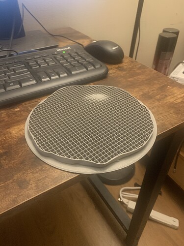

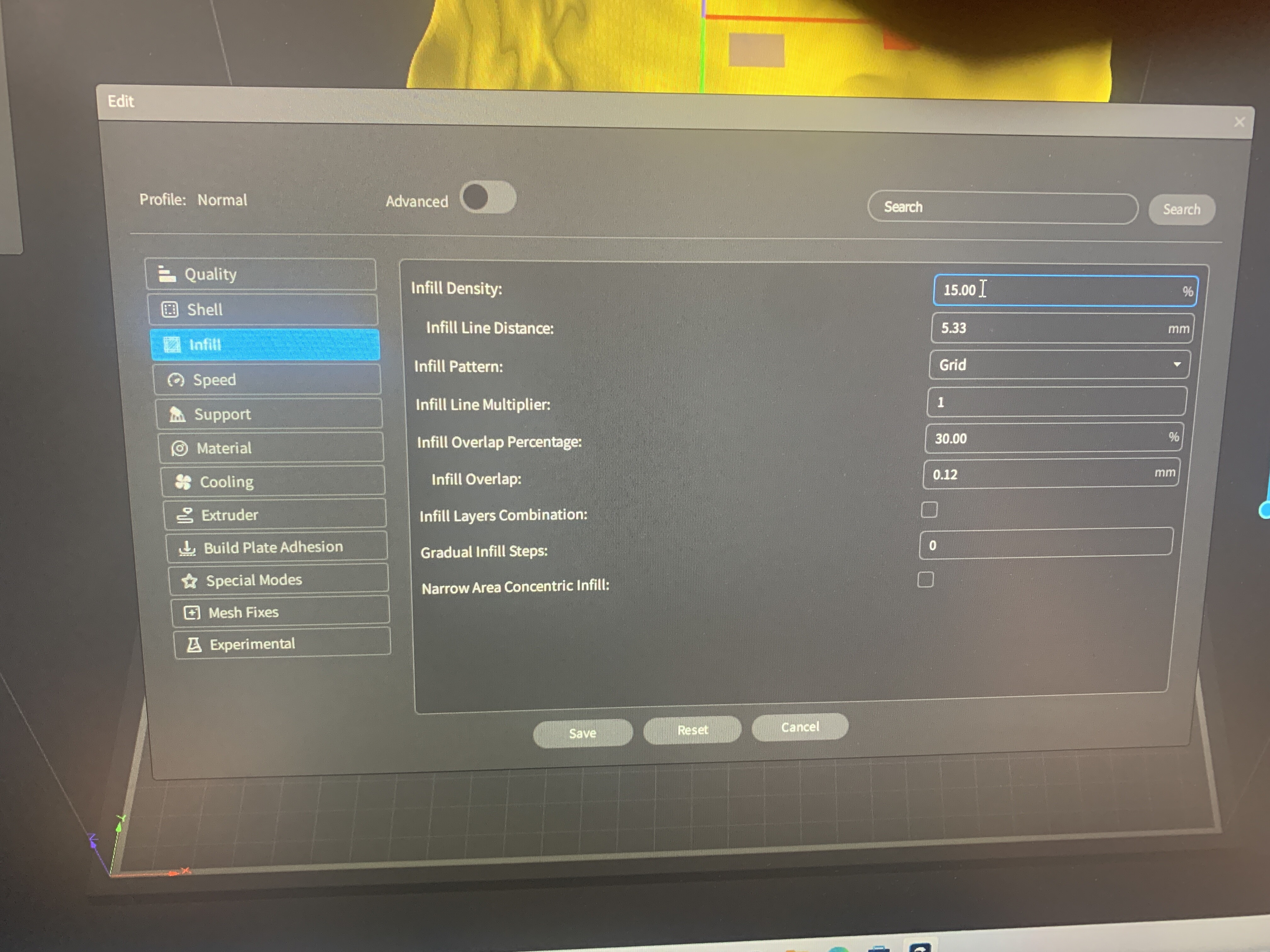

It printed the same model in full earlier. I changed the settings on the slicer to remove generate supports and it is stopping. It did print out a small disc and another smaller model no problem before a changed generate supports
Sounds like you changed something that has created the problem.
I printed a small round flat disc no problem.
Looks fairly normal. Support density doesn’t have to be that high but I don’t see how that would affect anything.
If other jobs are working, it has to be an issue with the sliced G-Code.
