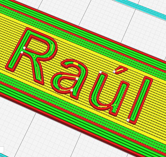

I ran you .stl file through Cura and found this.
The settings of line width of 0.4 show small lines in middle of the letters. When I changed it to 0.5 the lessened. Sometimes the font you use can cause problems. I have found hat Arial Narrow works well with 3D printing.
Give it a shot. See attatched.
