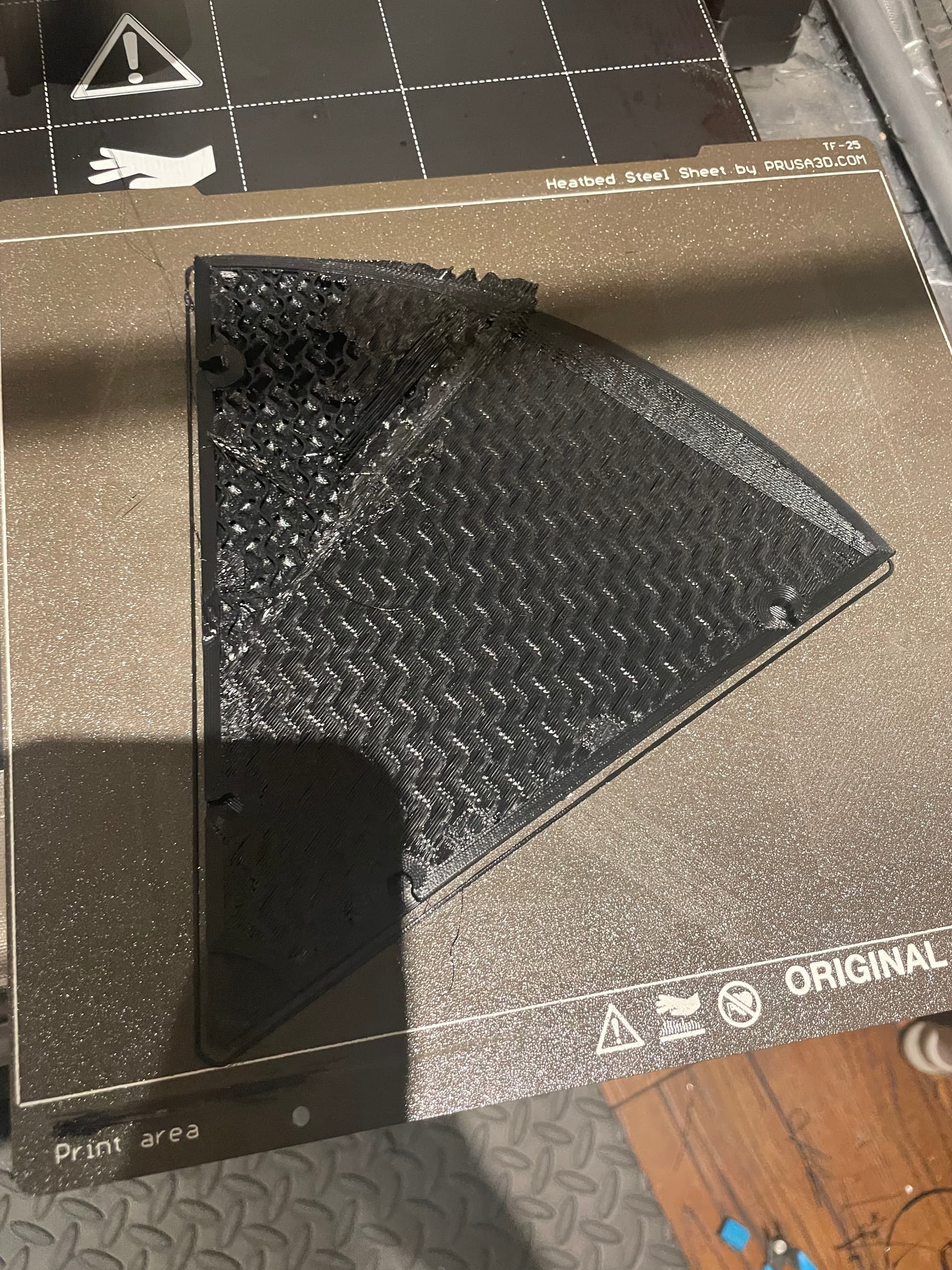

Hi everyone, I’m having a very weird issue with my prusa. I just had it in the shop for the second time in a month. They replaced the bed and hot end thermistors. I have had one successful print in the week since i’ve gotten it home.
The first was perfect then the second as soon as it started it was obvious the z-leveling had gone off…the printer hadn’t been moved, file sliced same way as the previous one…but suddenly the filament was not even close to laying down…
I adjusted the z-level and it seemed fine…i did a print…it was good but not perfect…then I did one last night…I started it and seemed to be ok…nothing had changed…i had to step away for a few mins…I always check the first layer every few mins…and i came back to the nozzle grinding on the plate…wth…(see pic) the z-level way off again…
I fixed again and started a new print and it seemed better but got these bumps and lines…finally stopped the print and did 5 squares trying a few diff temps for material and the bed…not a huge difference except at the lower temp i seem to get little clumps (look like a elevated line)

I would do a couple of things:
  1. whenever the printer is moved, or if you had a jam and had to pull filament out of the extruder, you might notice that the z-axis can move independently when the printer is off. This kind of thing affects the z-axis enough that you should perform a z-axis calibration. Other tell-tale signs that the cal is needed is when you get un-even first layer.
  2. Do a clean slice of your model with the PrusaSlicer defaults for PETG and default MK3S profile. If you see “modified” after your MK3S profile, something has changed, and try that.
  3. It looks like your first layer might be a tad low. I would raise it and perform a 1st layer calibration.
  4. Check, when the hotend is cool, by grabbing the hotend block and see if it wiggles within the extruder housing. It should be firm, not loose.
  5. Check the PINDA to make sure it is also held firm on the housing. If it is loose, it could mess up the bed leveling. It might be too far away from the bed and good live z numbers would be around -1 to -2. Anything greater than -2, means the PINDA can be lowered, and a z and 1st layer cal would need to be performed again.
  6. Are you using the sheet profiles? You might have satin and PEI sheets along with the textured one in the picture. If you have not been doing so, create your profiles of the sheets on the printer as these will have different 1st layer heights and be sure that you have the correct sheet selected before you start the print.
You mentioned you had both thermistors replaced. I would conform the shop had replaced them with the correct ones, I think it is the 100k the printer requires. When the printer is on but idle for the day, do both the hotend and bed temps appear equal and at room temperature? If not, this would indicate the wrong thermistors were replaced which would affect the quality of the print and bed adhesion.

It looks like the head is too low. Is the PINDA loose? Is the PINDA bracket bad. It it moves the calibration moves with it. The bracket is one of the places where I wish they did not use a printed part it just is prone to breaking.

The Pinda was a bit too high according to Prusa…I spent 2-3 hours with them yesterday and still no joy. I readjusted the Pinda with no real improvement. I would do a 1st layer calibration…it would look great then i’d redo the exact same file and it would be off again.
new clean slices…same issue
hotend is stable and solid no movement.
tried a new SD card no difference
wasted most of the day yesterday redoing the first layer over and over and over

Have you tried printing something else other than this object? It almost sounds like the object is not flat on the build plate in PrusaSlicer when it is getting sliced and its part of the gcode. Try selecting the object and select “Place on face” from the icons on the left side of PrusaSlicer, and select the face that you want on the bed, and re-slice.
Or…
On a new project add a box shape, unlock it and adjust the size so that it is a 50mm square by 0.2mm Z high. Slice that and print to see if you get the same results after a good 1st layer calibration.
