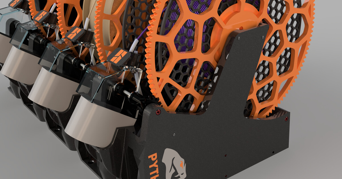

The mod introduces and gears spool system to the ams. This in my case eliminated completely retraction issues caused by low friction. It also sorts out cardboard spools and light end rolls. It is a fantastically well designed and easy to do it looks more intimidating than it is. The instructions are very good and comprehensive.
I don’t know or have affiliations with the designer but his designs are some of the best I have come across. Well thought out and fits really well. I have not looked at doing this to my AMS2 yet, but at the frustration grows it is more and more likely.

the pylon completely replaces the body of the AMS. They have an actively heated enclosure with the use of polymaker dry dock modules. I suppose you could design your own enclosure to use the sunlu but it costs more so it is a lot more work and cost.
Pylon is a substitute for the entire AMS equipment, which had active heating chambers with Polymaker Dry Dock modules. It is a fact that an enclosure can be designed for the Sunlu, but it will be a difficult task and costly as well.
