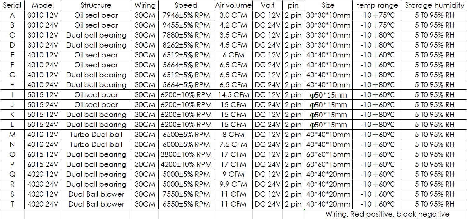

Before you buy any fan, there should be a manufacturer’s datasheet with a CFM (Cubic Feet per Minute) rating for the fan. Along with that, you should be able to find user reviews of the fans and their longevity - that’s a lot more useful than using the same brand of fans as is popular with PC gamers.
For a 4010, the best I’ve found is Aimsoar with 7.5 to 8 CFM. The datasheet above is from them. The fans are also pretty quiet - a few fan manufacturers also have noise specifications as part of their datasheet. I did do a bit of experimentation and the CFM ratings seem to be accurate relative to each other - for example I have some 4.5-5 CFM 4010s and the airflow is noticeably less than the Aimsoars.

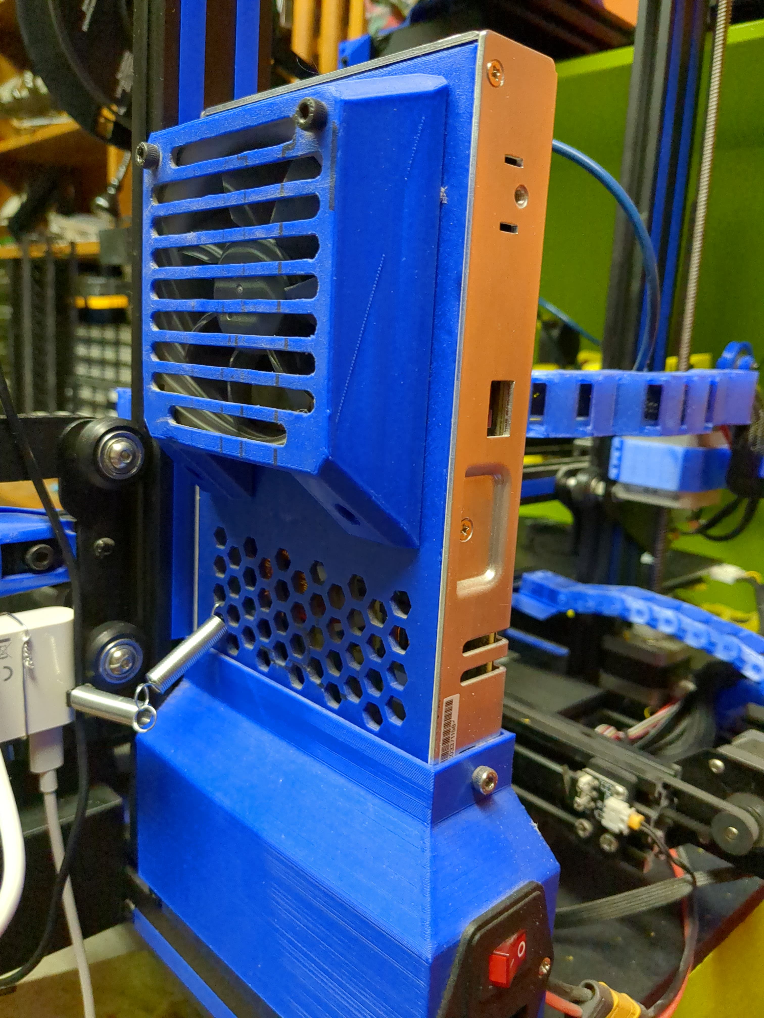

The cooling fan AND the power supply cover suck. The vent holes are partially covered for some reason and blocks the cooling air. That is the big reason I changed my cover and fan. I found a nice set of 92MM fan covers on Thingaverse and they fit perfectly. Going from 4010 to 92MM without the stock cover really helped. Excess cooling for the PW and the MB.
