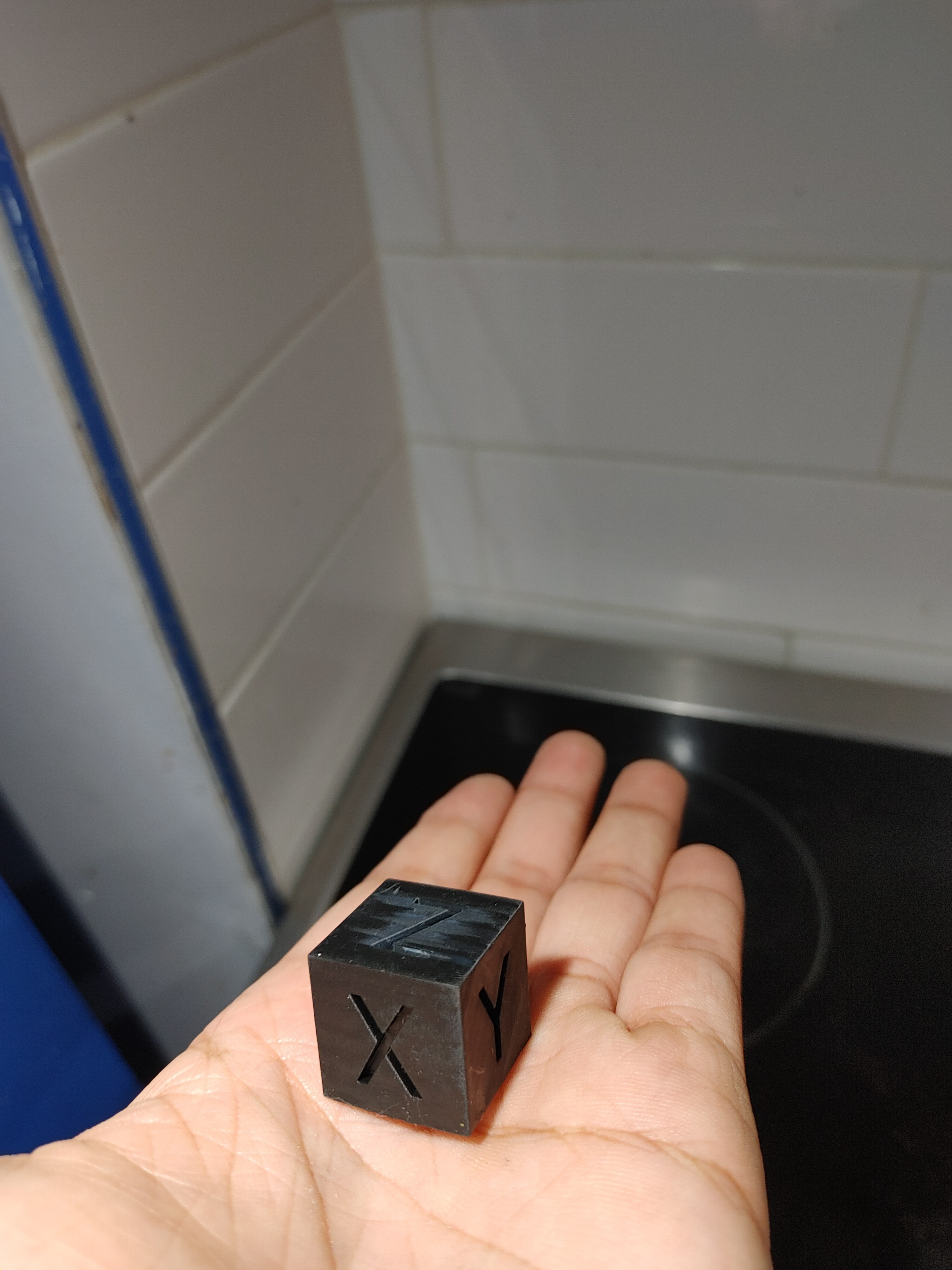

I buy my resin usually from 3DPC, but came across a new version, water washable.
First print, of something I have had success with, came out exactly the same.
But no need for chemicals to wash it with. Mind you its not just flush the water down the sink but still better than adding more chemicals to the transfer station and environment.

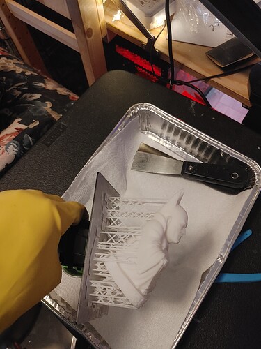

Just tried a larger print in a white water washable resin.
I think it’s a bit gummier than standard resin before curing, but the stuff still works really well! ![]()
With the picture, you have just solved a dilemma for me. Was looking for cheap, large container to land build plate and print into, did not think of tin foil roasting pan. Kudos!
