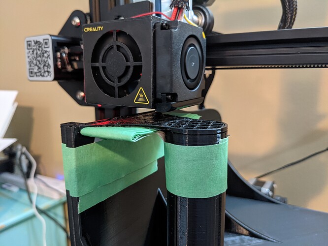

I’ll start. Had two tall and skinny supports fail so I built them back up with masking tape (didn’t have anything else handy) don’t know if this will succeed or not but I had to do something…
The supports failed just before a large bridge with a few hours left on a print that I think was over a full day. I didn’t want to waste that much filament to print again so I made my own bridge with cardstock and painters tape. It took a lot of pausing the print and restarting to tweak things before i got a good enough layer down for things to correct themselves on top of the tape.
It worked out surprisingly well. The print is a bit ugly in that spot but the part is still totally functional.
