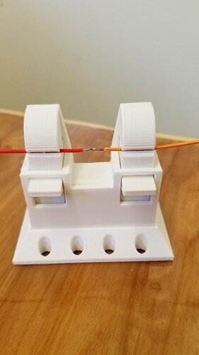

I just put up my design for a simple soldering holder on Thingiverse. It came about because I was soldering some microswitches and got totally frustrated with the two alligator “vise” solution and couldn’t find anything I liked for the task.
https://www.thingiverse.com/thing:5453048

I’m not sure how a printed spring would work in this case - when the jaws are shut, the spring is compressed by 5mm to give 1.5lb of force (yes I know the units are mixed, but that’s the way they’re listed on the McMaster-Carr specifications).

The yellow springs are much too stiff. They take much more than 5lbs to even start compressing - Moving them the full 8mm travel of the design would require 20+ lbs of force.
The McMaster-Carr spring was selected because it gives reasonable force when you press down on the jaws. Actually I think I picked the spring quite well, the jaws grips parts and wires well, but won’t damage them or take a lot of force from the user.

Just fyi, there’s a spring at Home Depot, 1000127103 (9/32" x 2") that works fine.
I did cut off three loops to reduce the strength a bit…
