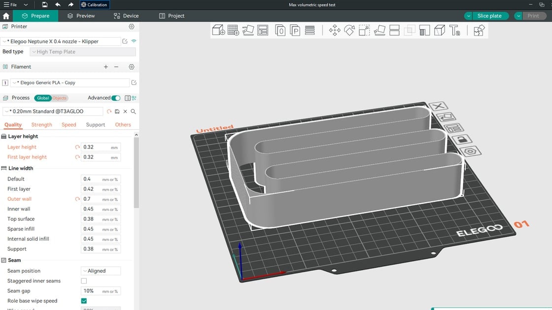

This test from Stephan is likely the most precise. Having done a blob and racetrack versions there are some issues with the blob. I have been mixing chemicals for many years and have access to high accurate highly repeatable scales. This is not common for most.
The blob method needs a really repeatable scale. The same sample weighed 100 times needs to be basically the exact same 100 times. With one gram samples a high repeatability is required. a basic cheap scale is simply not good enough.
My lab scale from work is +/- 0.001 gm repeatable. (optima OPH-P) The little mail scale I have at home is 0.5gm meaning the same 1 gm sample could read 0.5 gm to 1.5 gm. (It also is $2500 less money)
If you don’t have a good scale a racetrack type offers less precision but is not dependant upon equipment.
These are simple instructions it is specifically using the built in model in Orca but there are lots of models available in various platforms. The method is the same.
