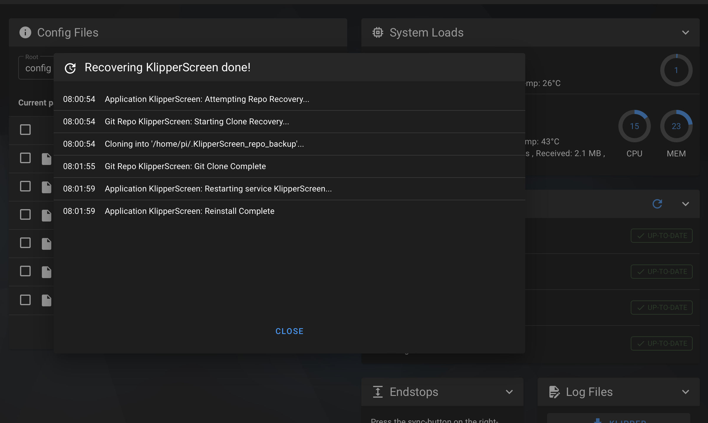

hmmm, something “systematic” happened not long ago that seems preventing my uploading g-code files; you mention a new version of moonraker; i cant find any way to do get that , even going thru everything on the printer web page; i did find a printer.cfg and a firmware.bin;
might you please send me a link that you might have used ?

i believe i have solved the problem; i suspected that somewhere along the chain i was running out of space; the mainsail interface exposes a section called “GCODE FILES”;
what i found there was all my successful previous prints, their sizes and a “space available of 22.5 MB”;
ouch, my usual gcode files these days are often 300 MB+…
so i deleted a few older files and refreshed the page and presto the amount available increased up to 4+GB;
they need fix that by adding a detailed message to the effect of " out of space ";
then i tried uploading a 340 MB gcode file thru cura directly via IP to the printer and it works, that same file was constantly failing before;
when the upload fails, there is no detail message other than “Upload of file failed”;
the GCODE section in mainsail strongly suggests that the GCODE files are stored in the destination root directory;
