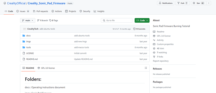

In the description of the video you can find a link to the Github site where you can download everything you need. Software and an older Firmware.
To download the ZIP file do the following.
Notice the green button with the word “Code” in it.
Click on it to pop up a menu of choices.
Notice the last choice “Download ZIP”.
Click on it and you will download everything you need.

Both the software you need (Phoenix Suite) and an old firmware file can be found in this Github download. The program is portable so there is no need to install it.

GitHub Web Page 04
