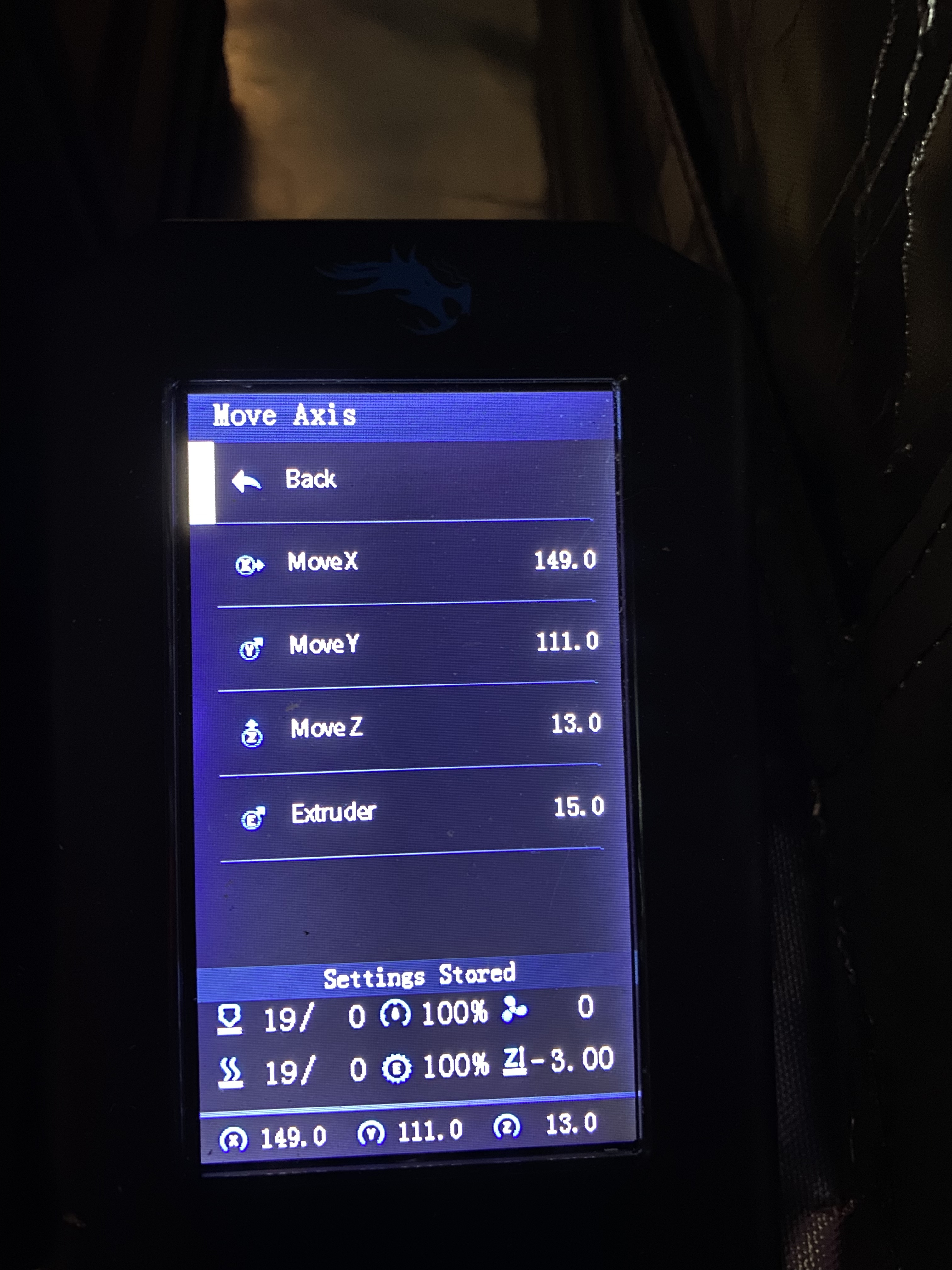

so your current Zoffset is -3mm. Most of my machines are sitting somewhere about -1.5mm.
What I would do I change the Z offset to 0.00 and save the settings, Home it and at this point you should not be smashing into the bed anymore. Then you can creep up on the actual setting that will allow you to print.
