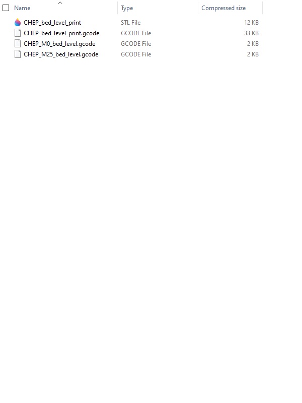

Thanks Jason, I have levelled the bed and want to do my 1st test print. I downloaded the files from CHEP website but I don’t know which file prints the test squares? See attached photo of the files.
I would think its the second one on your list. The first one is the raw STL file in case you want to test your own settings, The others are ones that CHEP has already sliced for you.
Although MR Hellibuck is a reliable source for Gcode files I would never recommend running Gcode files you download from the internet. As long as you are confident in the source you can run the files.
There are no Shelf checks or balances once they are in Gcode format. I did have a customer printer in the shop at one time, 2 times he tried to print the same Gcode file and it fried his mainboard. When I looked at the file It had a command in there to set the Amperage to the X-axis to 10000Ma. Basically 10 Amp. Although it would never get there the power spike from it was enough to fry the Stepper driver twice.

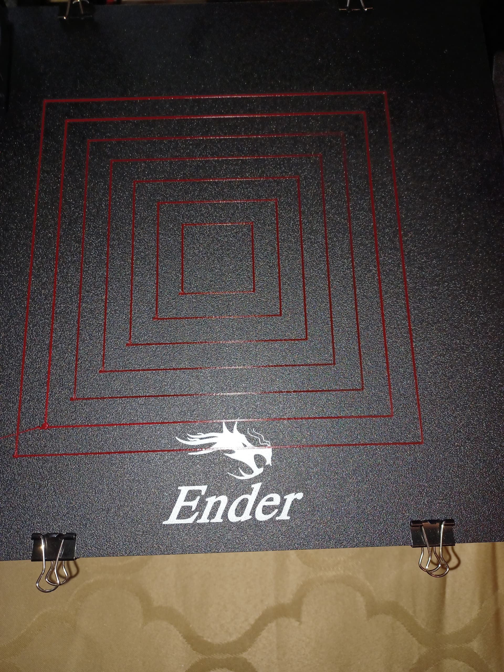

My first on my Ender 3 really pleased with it!

Looks great,
So glad you were able to get it going!
