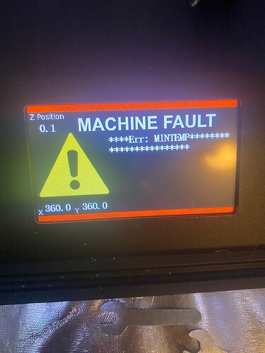

Hi I have an ender 5 plus and I am getting this error when I try to warm up my hotend and bed.
How can I fix this?
How can I fix this?

Have you tried heating up your hotend only or the bed only?
Prior to heating up, what ambient temperatures are being reported?
Also what temperature are you trying to print at? Maybe double check on your slicer its the correct temperature. Most firmwares have a min temp for extrusion of like 160-170 or so to prevent you from trying to print at too low a temperature.
Just trying to heat up the hot end. It showed -15
Using petg
Could be a bad thermistor, they do fail eventually.

When the temp reads -15 its a sign that the thirmostor is broken or disconnected. Check the connections at the back right corner there is one marked TH or T1, short for thermistor 1 or thermistor Hotend. If this connection is good, you will have to check it on the heater block, Usually its the screw there is put in too tight or the wire is broken. If you have a spare you can plug it in a the same location and if the temp reading changes to something close to 20 deg you now know the problem is in the wiring between the connection you just found and the hot end.

Yeah, when it shows a negitive number it indicates a bad thermister. Either a broken wire, or the thermister itsself needs to be replaced. No big deal
If I had to guess id say pay special attention to the wires near the hotend.
