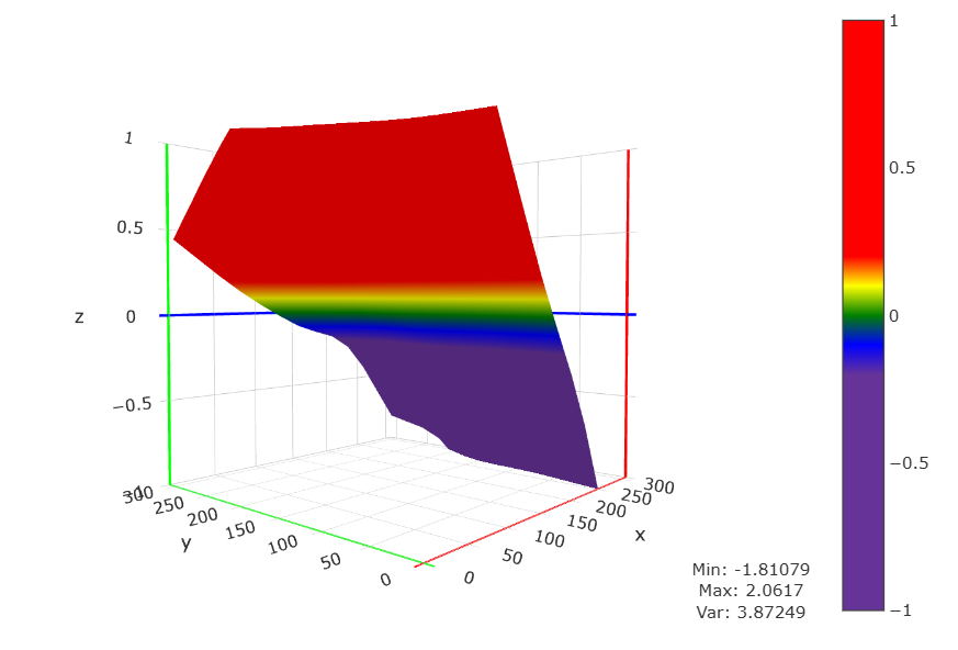

I started having adhesion issues. Cleaned the PEI sheet. 3 times. no go. checked the UBL. was ok. Not much play left as I was using the silicon spacers, and things were pretty cranked down to get my old value of about .8 mm deviation across the bed.

Just re-ran the manual levelling sequence using a 0.05 mm feeler guage. then the ABL. then triggered that again in Octoprint. This is one deviated bed!
If this anything like the last time I tackled this, it’ll take a lot of fiddling, unknown quantities of whiskey, and the air will crackle ultramarine.
I though mine was bad but it is OK compared to yours. Bed deviation sucks.
I have had some problems like that so I might go back to a glass plate bed & glue. Old school but it works. On my old Frakenender I usually levelled the bed once a year, whether it needed it or not.
Before the silicon spacers, I was retramming every other print. And it sucked. That’s when I started adding locktite to stop things from vibrating loose. The silicon spacers really did the trick and I didn’t need to re-tram for over a year, at least not until it started working at severing the print head ribbon cable.
