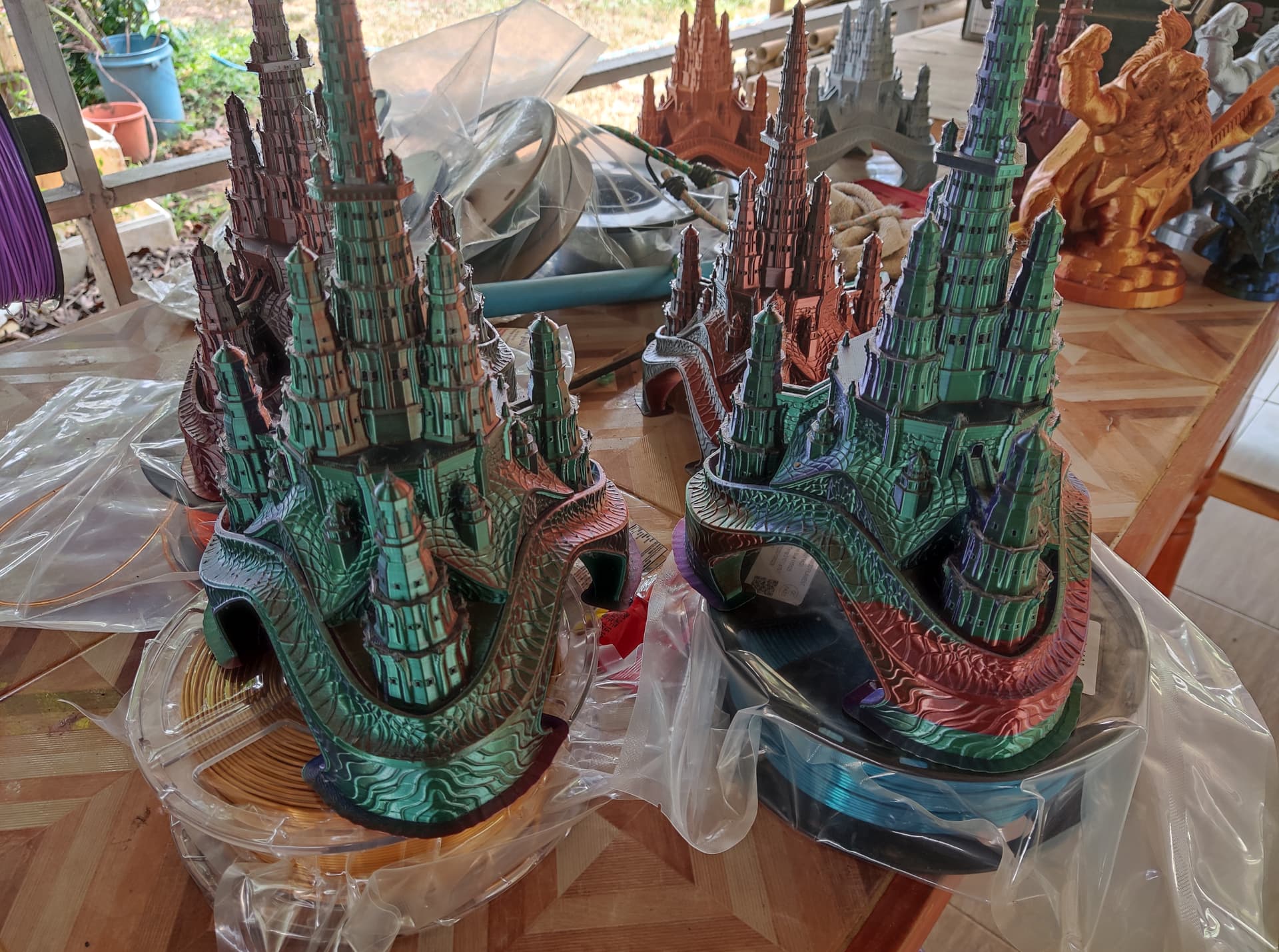

doubt that share works seamlessly: below is an example (cepora tower) of the standard tri-color print on the left-front and the anomaly print in the front-right; the copper band is introduced …printing this model with the same tri-color 5 other times always yields the version in the front-left ( each side is a different color but they are consistent);

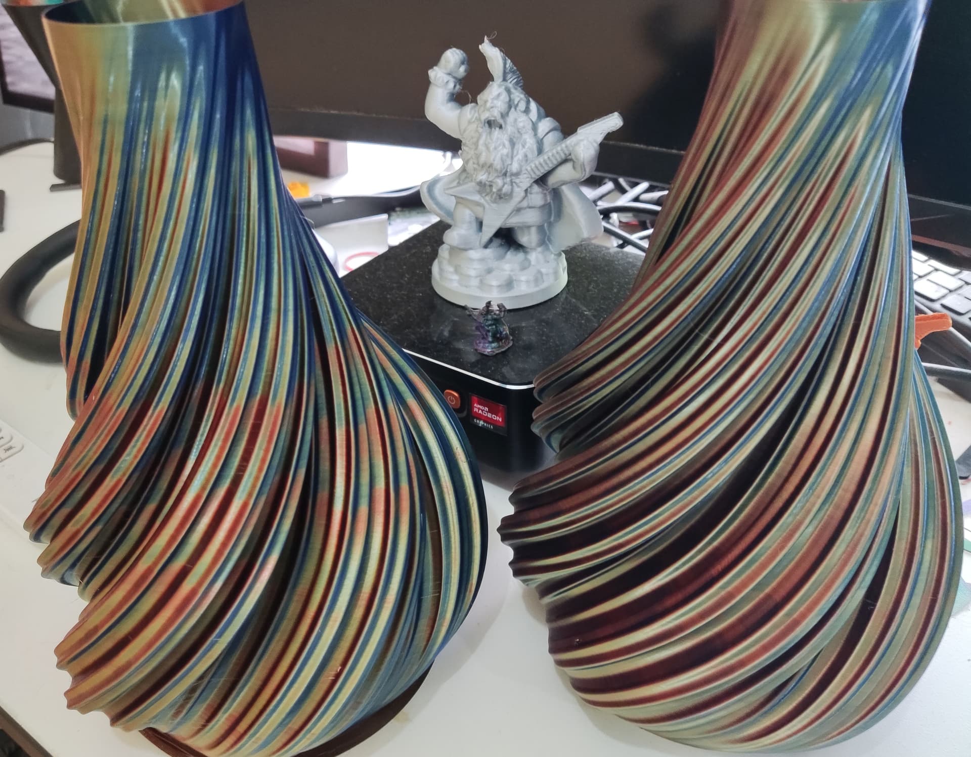

the next pic shows color banding where it shouldnt be ; i have printed this model quite a few times successfully with the tri-color; this one was a failure based solely on the tri-color; same printer, same g-code
here is another example: this one shows a successful vase ( spiralized contour ) on the right and the failure on the left ; same g-code, same printer ; same spool of filament;
so even within the same spool there is a ghost in the works
