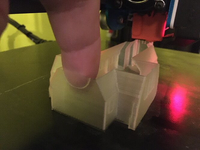

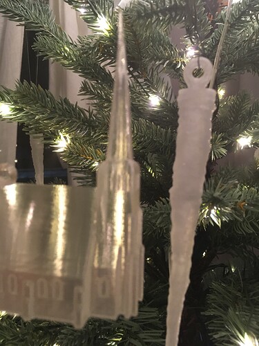

This is a model of the church my dad attends, he is 97 so it plays a big roll in his life. It is in vase mode from iiiD max crystal. The icicle beside is also base mode but it is clear PetG in the 3D pc brand.
The iiiD is far more clear. There is a lot of variables if you posted a photo perhaps we could offer some different opinions.
I printed at .2 with a .4 nozzle with a mk3s+ the rest was default for vase mode.

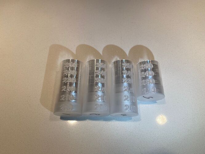

I modeled a temp tower earlier and just running the last couple of speeds now.
I will post the results real soon.

Ok, house brand PETG clear. Very dry.
Ender 3 Pro Max with magnetic base.
0.6 tip with .3 layers, because life is short, unless you go to church and live to 97 so far.
As you can see, there seems to be a speed : heat ratio that impacts clarity.
Instead of using speed settings, I maxed everything out and set Minimum Layer Time setting to control for speed.
The model 15mm radius, and I printed it at 6, 5, 4, and 3 seconds per layer, and figure the travel speed at 15.7, 18.9, 23.6, and 31.4 mm/second.
After the second test, which barely held together, I gave up on 200 degrees because the layers just weren’t holding.
So the third test was manually adjusted to start at 210, and I changed the model for the forth to eliminate 200 and 210 altogether.
