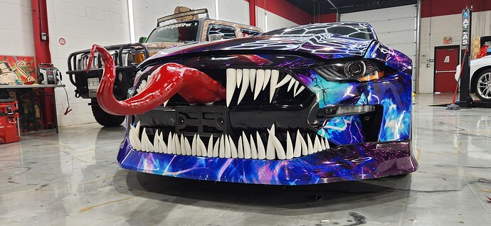

I vinyl wrap cars for a living. This is a Venom package Mustang GT with a printed Venom wrap. Customer wanted something crazy so thats what we gave him.
Tongue was printed with 3.5KG of ASA in 5 different pieces, plastic wielded together, primed, sanded and painted. Teeth in white ASA.
Each tooth was screwed into bumper cover and tongue bolted into bumper frame, yes he drove around with this on.
