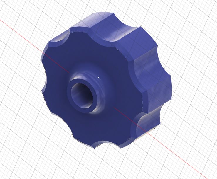

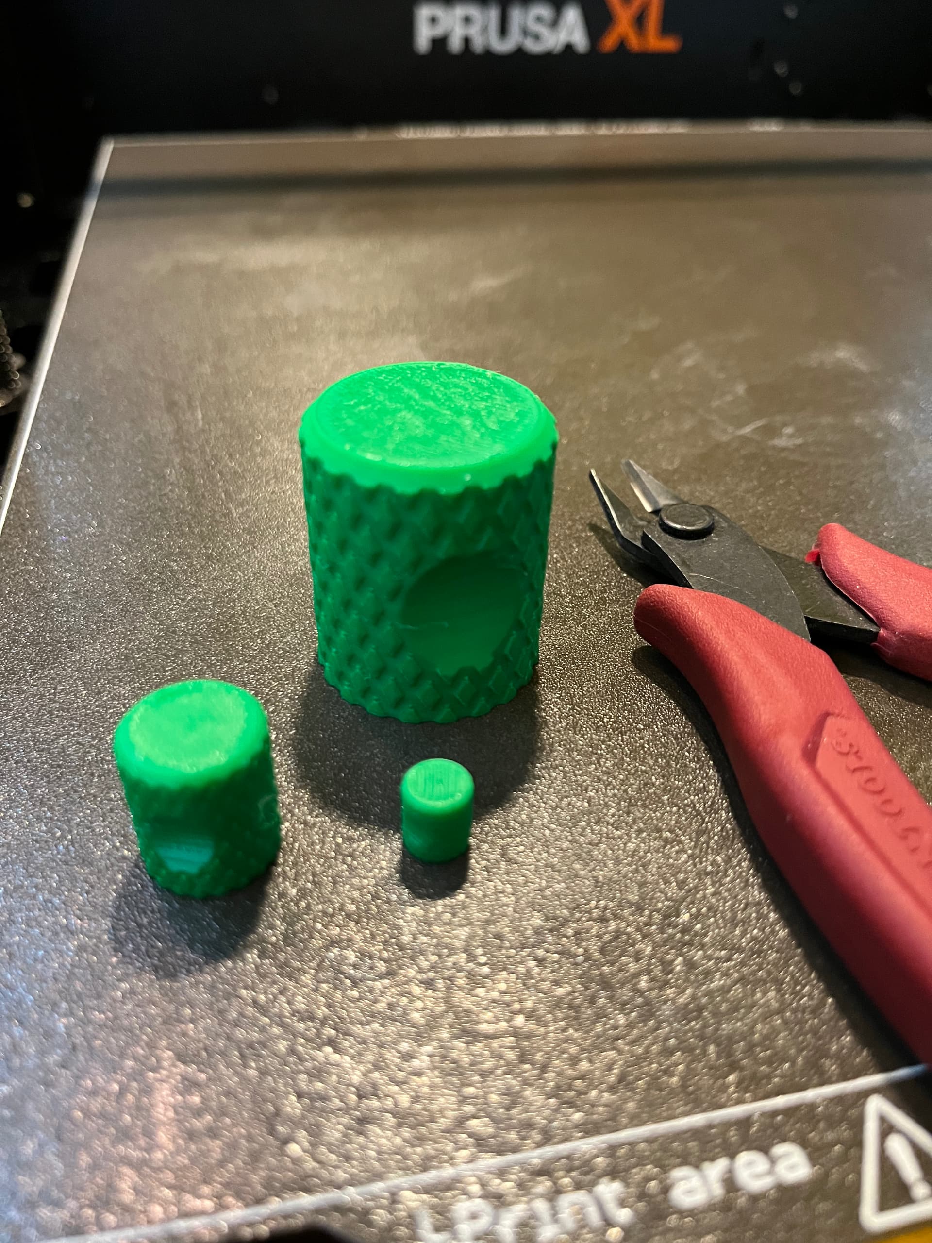

This is something I tossed together. It is a simple design, thought really. I considered that scalable and editable means likely a slicer. Anyone should be able to scale it in a slicer and add a hole for either a screw, bolt, or insert can be done with a negative volume in a slicer too. It might have issues with the knurling as it scales, slicer settings dependant.
tinker all you want, it is a start not a finish.

I printed three versions last night. full size, 50% and 25%
The side notches seem too shallow.
The knurling is visible on the small one even with a 0.6 nozzle.

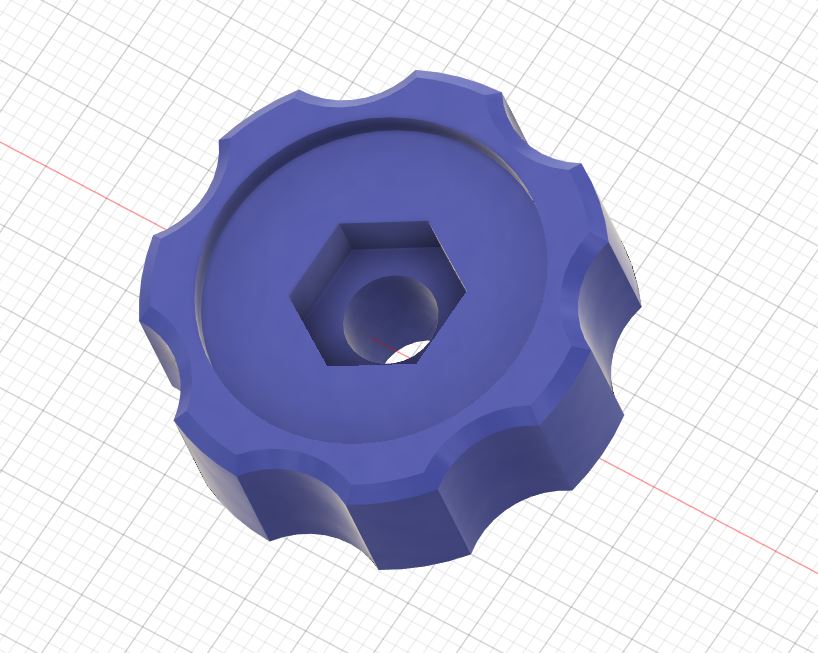

I created this knob for a specific application. It is made to have a 1/4-20 hex cap bolt go through it and the recess on top was for a printed logo insert. Scaling this may be problematic as the hex cap size for the bolt my not work when scaled. It would have to be redrawn with parametric values added in Fusion360 for it to work.
If any one wants this as is, Dropbox
