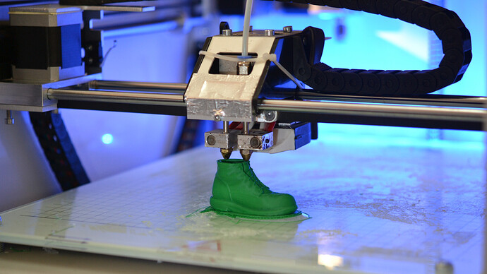

One of the most common types of 3D printing is fused deposition modeling, or FDM. “It’s the cleanest with regards to space,” says Haidar.
With this method, there’s a spool of winding filament (usually plastic or polymer) that is fed into the machine’s head. Inside the head, there’s a heating unit that melts the polymer. Polylactic acid (a type of plastic) is one of the most commonly printed 3D materials, because it’s cheap and has a fairly low melting point of around 180 degrees Celsius (350 degrees Fahrenheit). When it’s used as a feeding material, engineers usually set the 3D printer to around 200 Celsius (390 Fahrenheit) to make sure the material is going to be melted as it’s extruded from a little nozzle, but can then harden back into form. The smaller the nozzle, the more resolution there is in the printed object.
